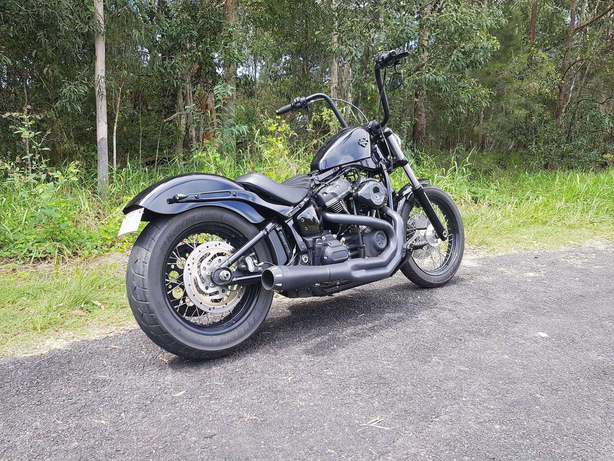

Originally Posted by Birtyyy
I just picked up a 17" X 4.5" rear off a Dyna Street Bob, from what I've read should be a pretty straight forward swap but I'll soon find out!
Don’t mean to dig up an old post, but did you get that on? I am thinking about taking my hub from the softail and respoking the dyna. But I’d like to bolt up the whole thing if it’s doable.
tnx
Old May 29, 2023 | 07:19 PM
Birtyyy's Avatar
Birtyyy
Joined: Nov 2015
Posts: 215
Likes: 110
From: Brisbane, Australia
tnx
Yes I have a dyna 17"x4.5" rim laced to my FXBB hub.
also didn't throw any ABS codes as someone mentioned might happen.
2019 FXBB with 17" x 4.5" rim
