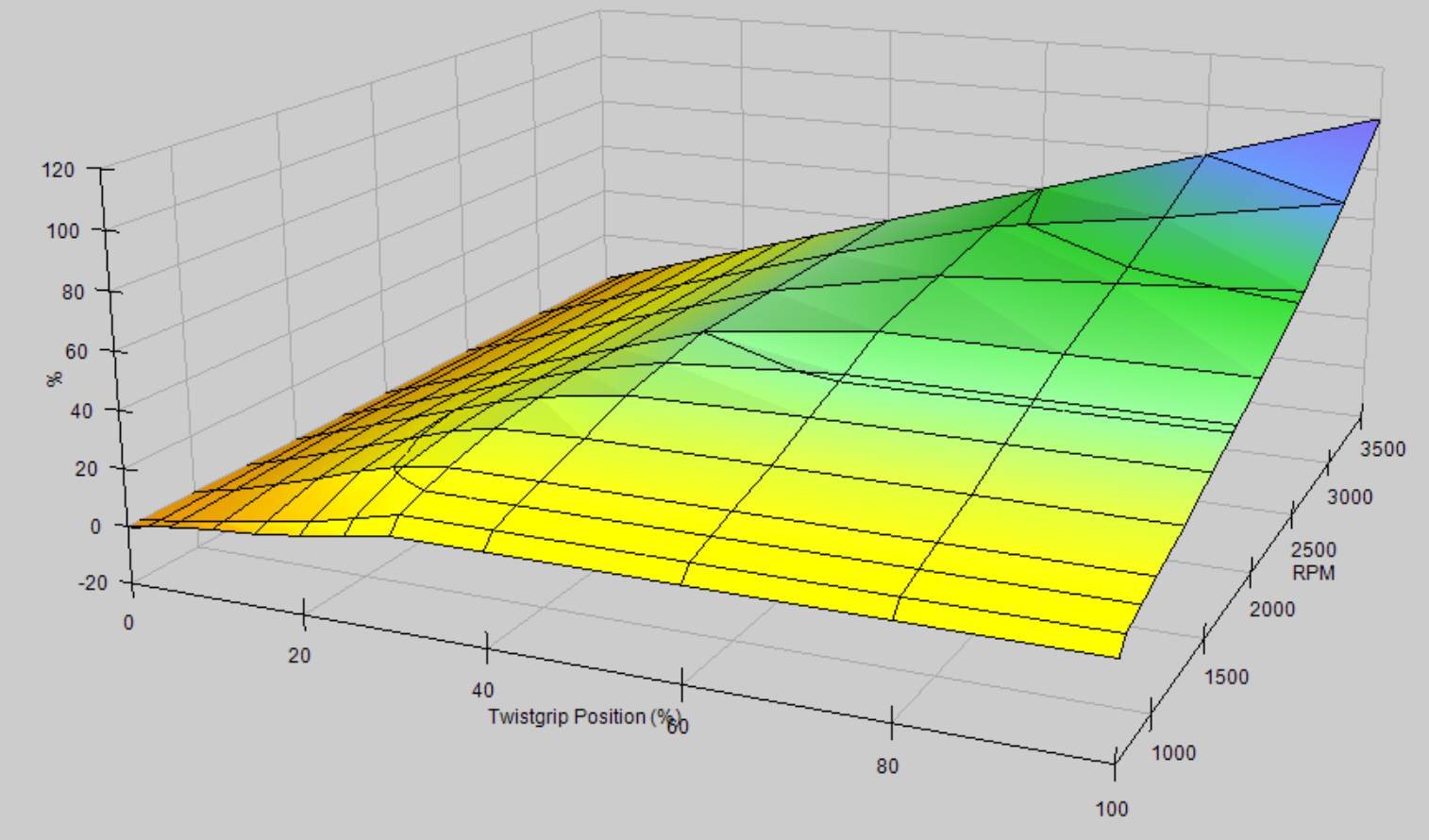

Originally Posted by supernac
You can modify the throttle response with the Harley se tuner, no dyno needed.
Correct me if I'm wrong but doesn't that just adjust the servo position slightly? So that it puts more throttle per the twist of the throttle over what normally would be?
I remember reading that somewhere but im not sure if it's true.
I think you are on the right track.
It turns up how fast the butterfly opens.
Ideally the computer will open it as much as road speed, load, rpm will take without pouring to much gas to it.
Twist it up a notch if you want after that you are probably defeating the motor.
I played with it on a 2014 sgs with an fp3. I could set it to normal, race or 1 to 1.
I was hoping for a 1/2 twist to be wide open because i have a messed up right hand.
It doesn't work like that. It just speeds up the opening of the butterfly.

Default Throttle Progressivity
Here is a plot of the throttle progressivity that I am using on a 114 stage II from my H-D Street Tuner. As you can see, the throttle will never reach 100% open below 3500 rpm. The throttle body is big enough to flow all the air required at less than 100% open below 3500 rpm. No more power to be had from opening the throttle more.
These settings are determined on a dyno like Jamie at Fuel Moto said to someone who posted earlier.
Also, at very low rpm the throttle is made less senitive to make low speed manuevers easy and putting arround at 30 mph smooth and not jerky.
