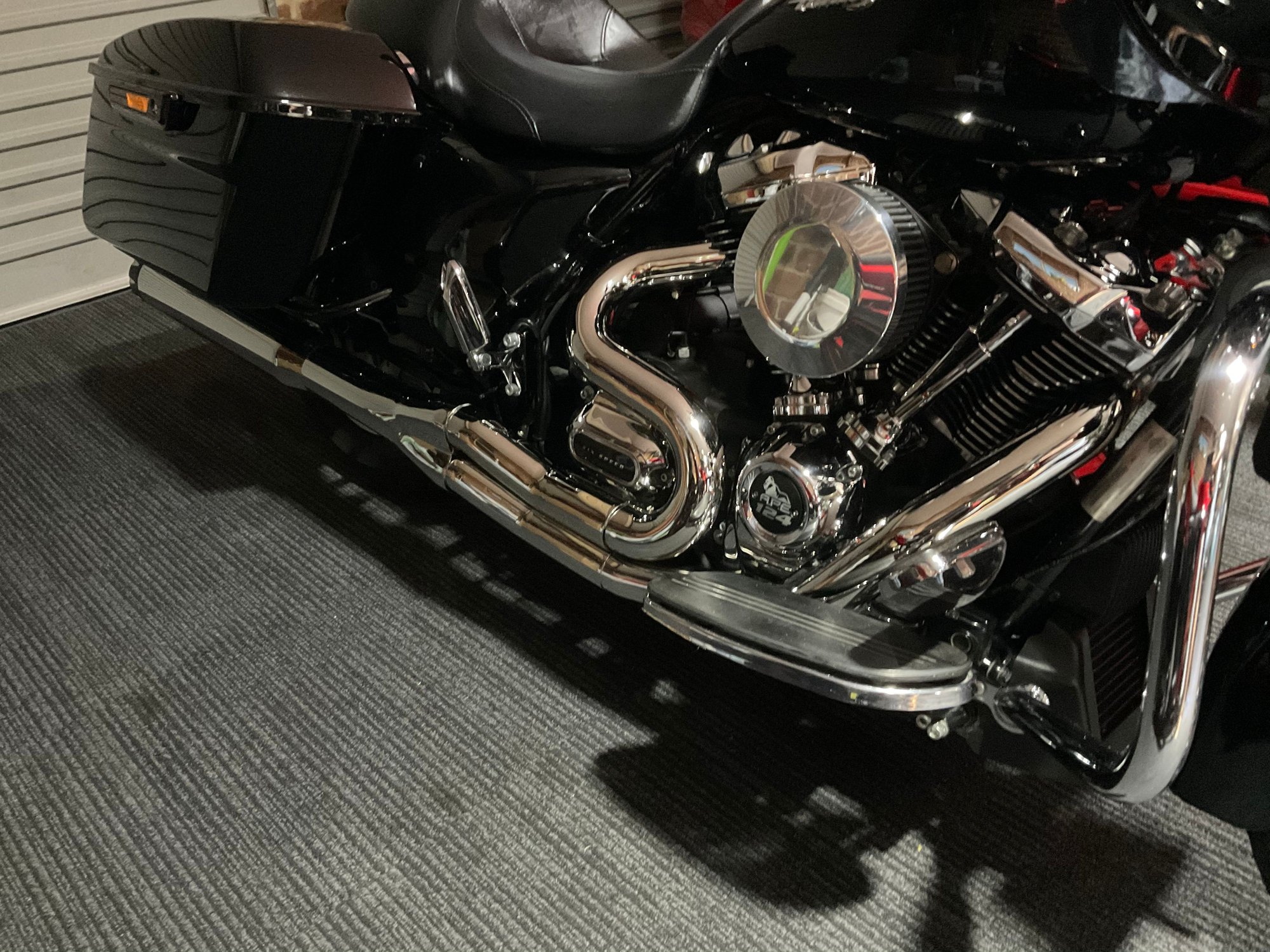

So glad I found these posts. I just had a 124 kit installed in my ‘17 RGS and am experiencing exactly this problem. 150hp and goes like a missile above 3500 rpm, but below that is quite lame, only pulling mid 130s tq. Yes I have a mid range cam CR470, but it seems the high hp Bassani 2 into 1 is too free flowing, check the size of the collector. The supplier of the 124 kit is sending me a S&S db reducer, so I’ll be keen to see if it lifts the torque curve below 3500 like the dyno chart comparison above.

I'm keen to see if a S&S dB reducer fits a Bassani muffler.

I’m told it does. Will soon find out.
