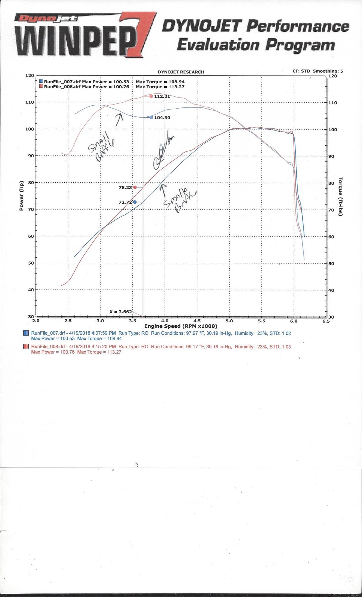

Originally Posted by Joweyenb
Got 2:1 S&S Super Street exhaust system / SE Pro Tuner for my new 2020 low rider S. Super excited. Dealer will install it on Friday. Question: I heard the S&S sounds really better without the dB reducer, and it’s easy to remove. But someone on this forum said removing dB reducer significantly cuts low and mid range performance. Is that fact or fiction? Why would it have such impact on low / mid performance? I definitely don’t want to cut performance of this awesome bike. Thanks!!
If you have the stock cam, there may not be much difference. Some cams are very sensitive to exhaust with reversion issues.
I have noticed that most people really slow down with loud exhaust. They turn the throttle to get the sound they want and if that happens with less throttle they just go slower and don't notice 'till they follow me.
Here is a comparison with two muffler's. One is too "open".

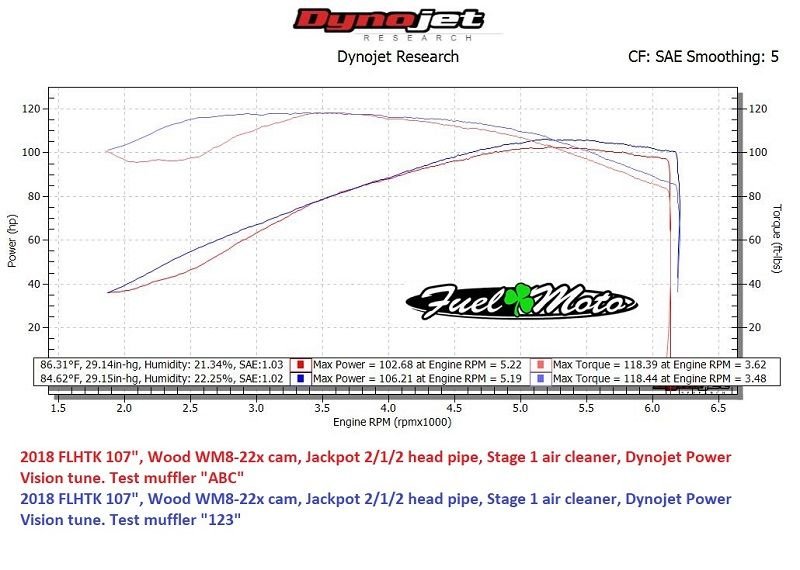

In this example it's even more noticeable... So it really depends on how you ride. You can get more torque with higher rpms, but down low it's noticeably soft.
Blue is with baffle, red is without.

Originally Posted by Dan D.
In this example it's even more noticeable... So it really depends on how you ride. You can get more torque with higher rpms, but down low it's noticeably soft. Blue is with baffle, red is without.
That's a poor situation, either give up bottom end or give up midrange.
