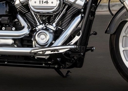

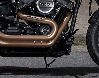

Fat Boy
For example, Fat Bob
Both photo's are a bit from a different angle but the master cylinder sits at the same spot. Some people think everything changes
wen you go from mids to forwards, well it is not the MC stays on his place, just the rod is different in length, same with the boards.
