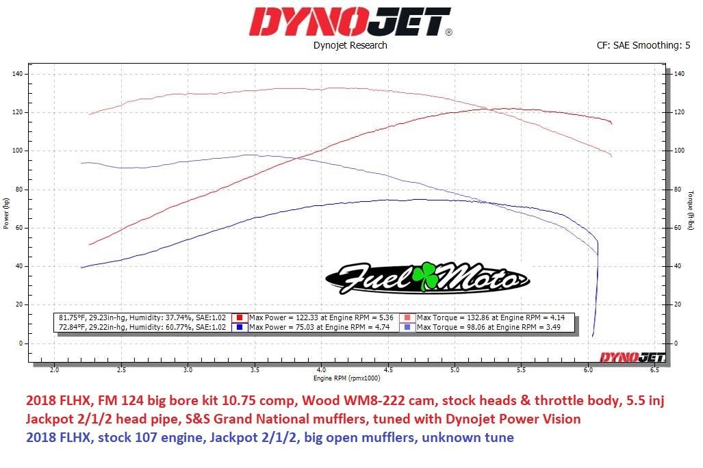

If you're going to remove the top end for more displacement, I would go with this "low compression" kit from Fuel Moto. You can use your torque cam or another similar cam with it. Fuel Moto can also provide you a tuner, larger fuel injectors, and an engine calibration file. Give them a call. https://www.fuelmotousa.com/i-238981...7-engines.html

Thanks, Hulkss. That's a beautiful torque curve. I'll look into Fuelmoto.
Are you sure about that? I was told it was a no-go with my SE-447 cam, IIRC they said the cylinder compression would be too high.
The stock cam has an intake close angle of 1 deg ABDC with a static compression ratio of 10.5 (114 engine).
The 447 cam has an intake close angle of 17 deg ABDC so I think it would work OK at 10.75.
Fuel Moto has built several with the Wood WM8-22X cam that has an intake close angle of 22 deg ABDC.
Fuel Moto will know best for sure.

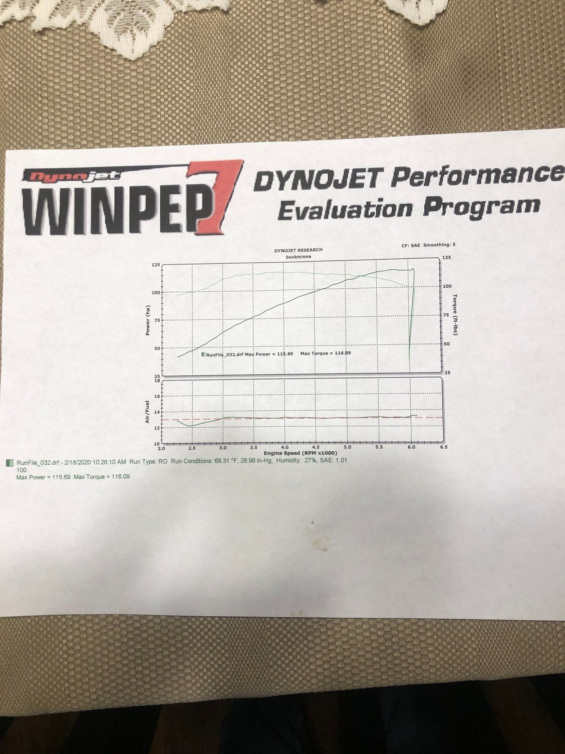

Not the power of that big 124. But a pretty nice broad torque curve on warrantied SE tuned stage 3.
116 HP 116 TQ
