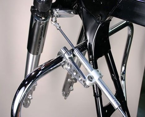

This one uses the Shindy stabilizer nad made for the older baggers. Looking under the Heritage triple tree, we have two cables but I dont see a real problem. Bracket should be able to be modified or attach to the fork.
