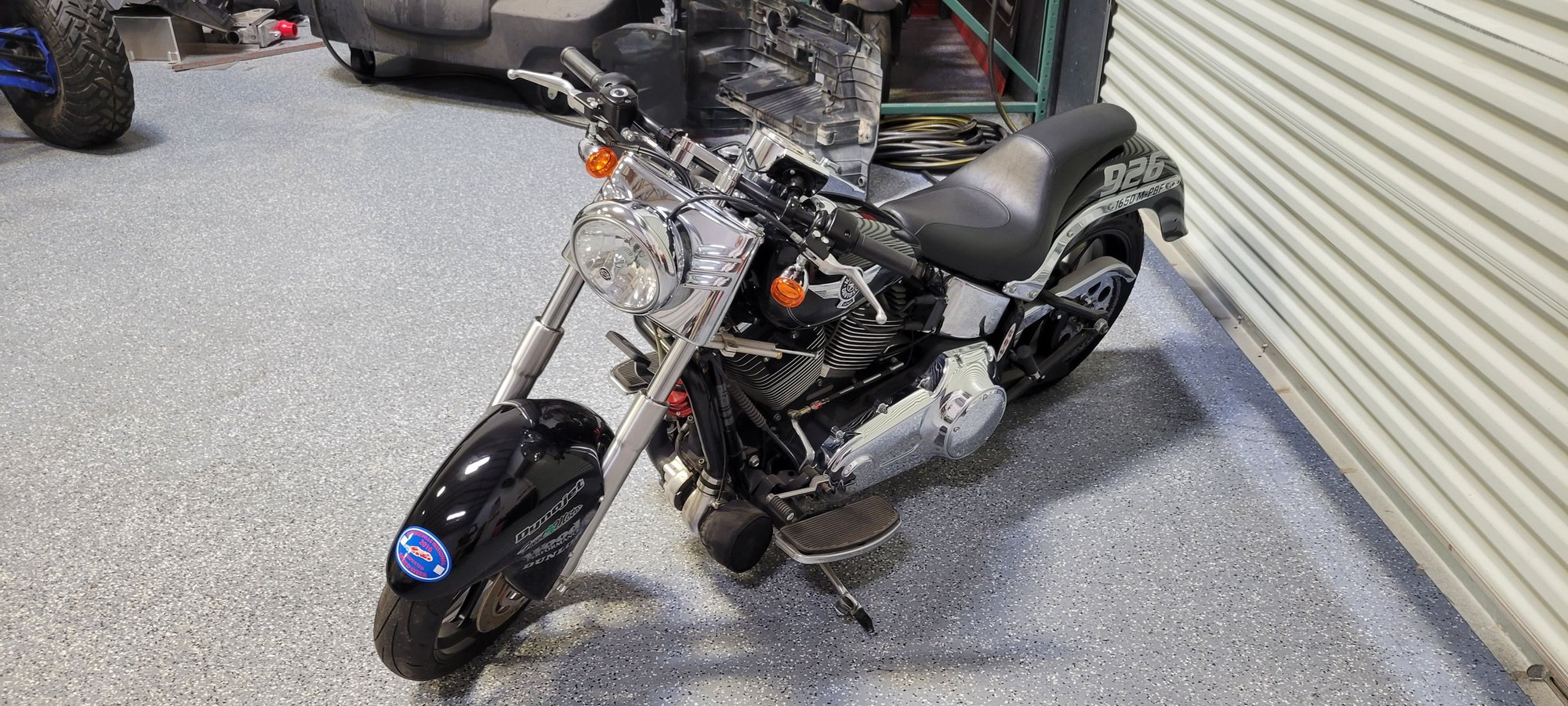

You can just see it in this picture, but my bike had a damper on it for Bonneville. The fork covers below the triple clamp were removed and a mount was added to the fork leg, then another bracket to hold the Ohlins damper was put on the frame tube. It's a 7" stroke damper. For the street, I have removed the damper and reinstalled the fork covers. No stability issues so far (only been 155 on asphalt with it so far).
