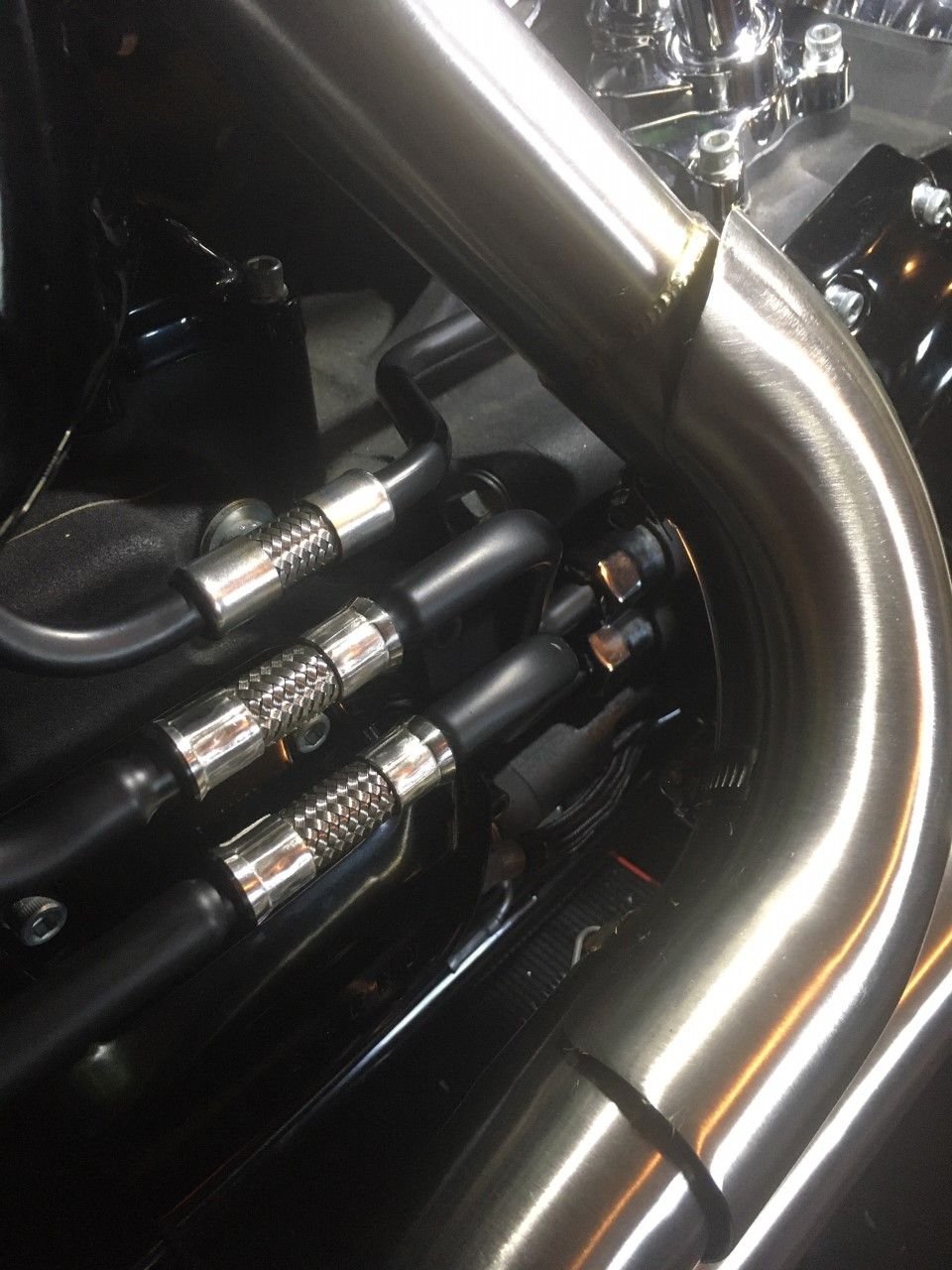

Here is a TBR 2-1 M8 exhaust on a Twinkie.
People said it couldn't be done but it can!

Were there any mods required?

Well I'll be damned, that is very interesting indeed! Good to know as that means there are a lot of possibities.
There was two modifications I had to do on the bike, not the pipes. I had to make a new oil vent line because the rear exhaust was
hitting it, the M8 do not have these oil lines like the TwinCam does. And, I did a little work on the Cam Cover because the front pipe
was a little close and I was worried it might get hot enough to discolour the powder coat. If you look at pictures of the TBR 2-1 exhaust
on M8 models you will see that the front pipe is very close to the cam cover anyway. The front and rear header pipes are separate pieces
so it might have made it a little easier to fit.
