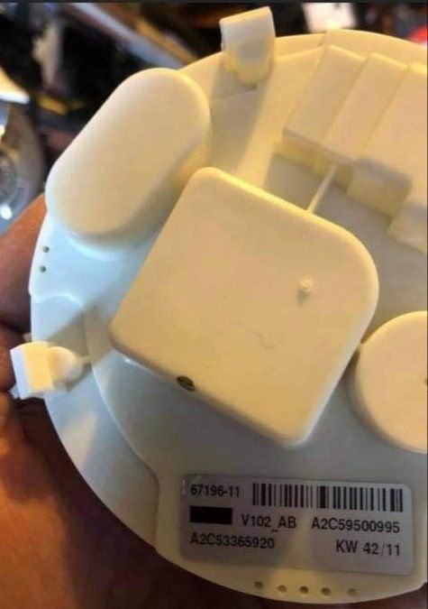

My 2018 Heritage speedometer fogged up for 2 years. It didn't matter if it was cold, dry, humid, damp, wet, etc. It would fog up so bad you couldn't see the read out (fuel, gear indicator, clock). This is my seventh HD and none of my previous bikes had this issue--and I live in NC where the humidity is high in the summer. My dealer was absolutely no help at all with this issue, and refused to replace the speedo while the motorcycle was under warranty. I was ready to order the Dakota Digital replacement when I decide to try something. I figured I didn't have anything to lose, and my warranty had expired, so I removed the speedometer from the dash and drilled 4-5 tiny holes in the back; exactly under where the display would be located (it's easy to see where to drill). I think I used either a 5/32 or 11/64 bit. I took my time to make sure I didn't hit anything as the bit cut through the plastic. That was in July of this year, in the heat of the summer when our humidity is high. Since I did this, my speedometer has never once showed any signs whatsoever of fogging. This 15-minute fix saved me the cost of a new speedo and a lot of frustration. I love my M8 Heritage, but I was seriously starting to look at other brands.

I saw this subject posted here before and copied a picture I saw there for an idea of the small drill holes. I'm going to have my dash apart this off season so going to do some drilling myself.

Honestly, I didn't even think about that. I just took my time, used my variable speed drill and went slow. Most, if not all, of the plastic ended up on the outside of the case or on the bit. It's really pretty soft material. As I said, I had nothing to lose. If I screwed it up, I was going to buy a Dakota Digital. It's easy.

yup dealer can replace these 100 times no help as all units are faulty. So far seems drilling this tiny holes is only way to help with fogging. I still try to wait for more confirmed cases of this fix but so far 2 people I am aware tried it and it worked for both of them so I am optimistic.
