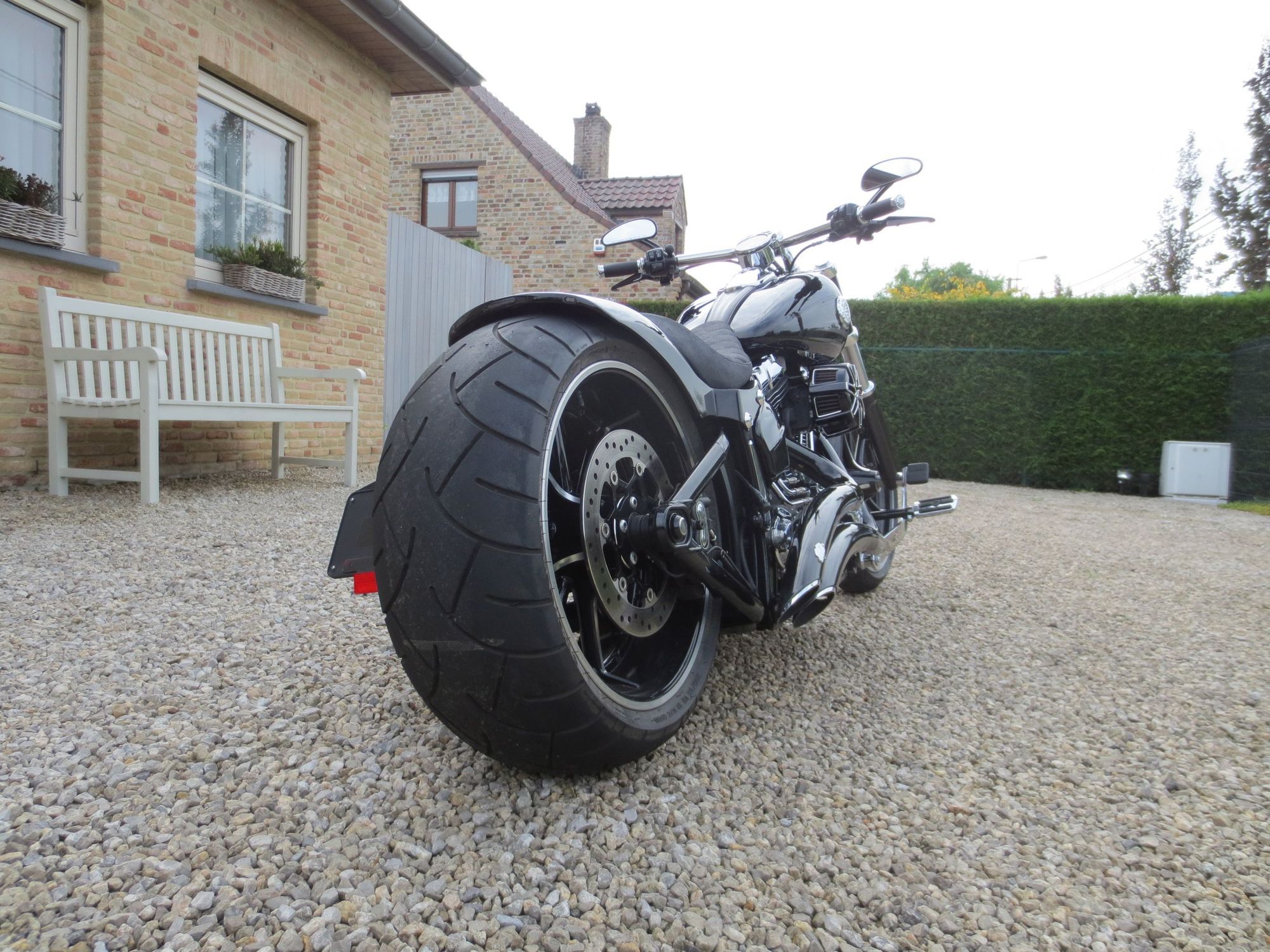

I have SAS airshock on it but as said more a looker then a driver....
260 Metz

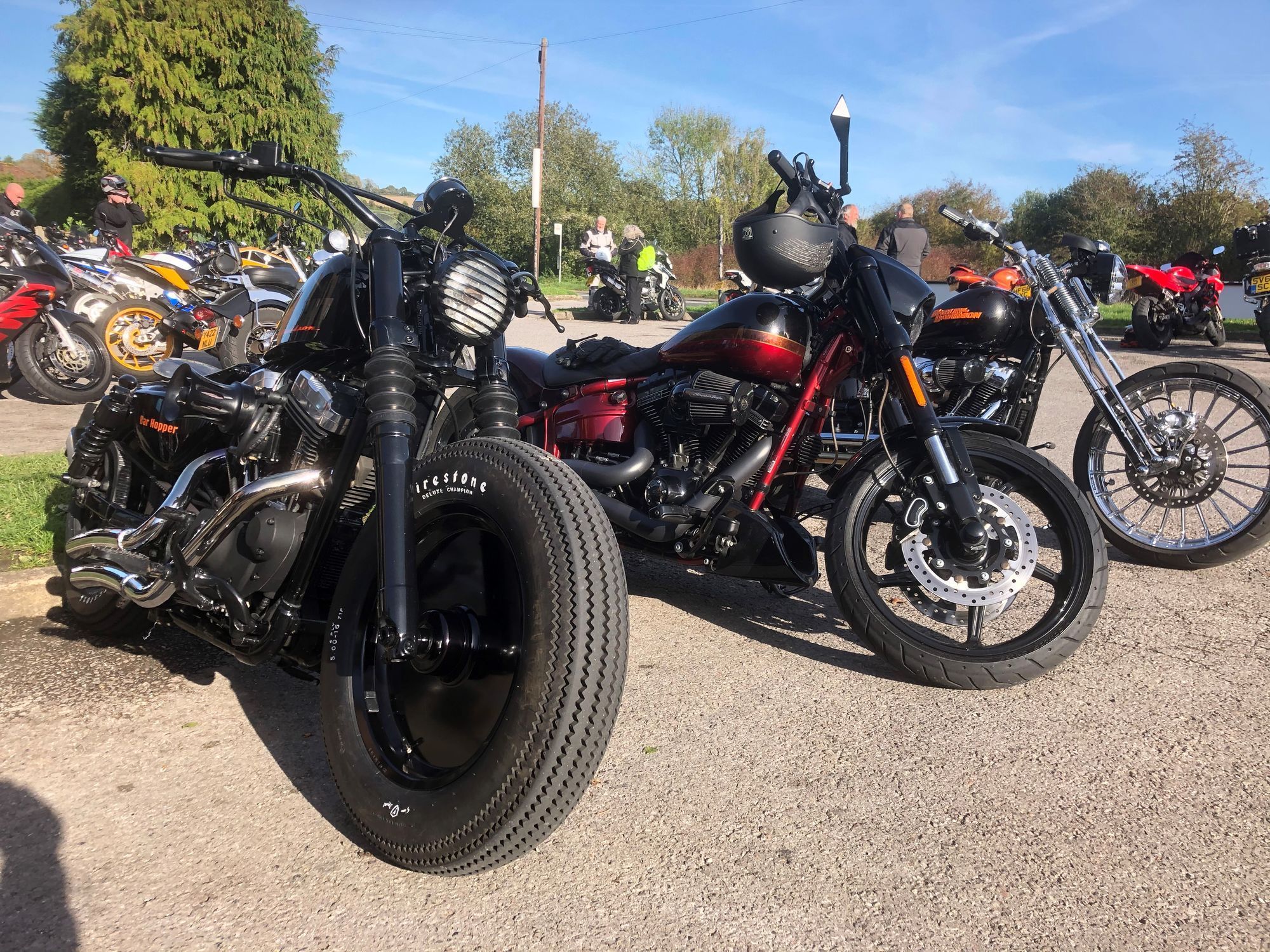

I have two riding buddies I head out often with both ride modified Harley Davidsons. If we are heading out using major roads I will take the B.O.
Nevertheless if we are taking rural backroads or the coastal route to get somewhere often I’ll take the FTR and due to the fact I’m not wrestling with my own B.O I get to witness how much of a struggle it can be. I quite enjoy having a bike that you have to ‘work at and work with’ to get the best out of it but there does come a point where you do just want to enjoy the ride rather than have to keep your concentration levels off the chart just to get somewhere and keep your bike on the road.

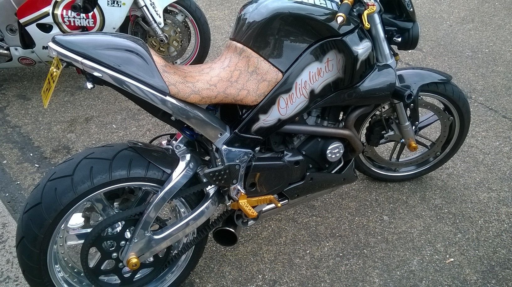

A good condition Buell was also on my potential list as a second bike too but good examples can be hard to find. Here are a couple that I see locally out and about and quite often.
