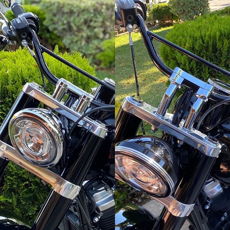

Somebody more experienced than me can chime in, but I would assume yes. I'm 5'8" and I wanted to bring the bars a bit higher and closer to me too. For me it's was mainly because I was having upper back soreness after long rides. I liked and kept my Hollywood Bars on my Slim and instead added 4.5 inch risers and the wires and cables have JUST enough slack so that they're not tugging when I turn the front wheel either way. I also had to re-route the clutch cable so that it's behind the handlebars instead of coming out the front through the forks.

I got the Drag Specialties 4.5 Pullback risers which take all the stock bolts. I want to say that all the risers take the stock bolts, but i could definitely be wrong. If you decide to get the ones like mine or similar, you just have to get the matching top clamp since some are a different shape then the stock HD clamp and the top bolts are offset. You can get them both anywhere online or our scour Ebay for a bit for NOS (New Old Stock) deals or used one still in good shape.
As for the re-routing the stock clutch cable, yup, I had to disconnected it from the lever. Just make you give the clutch cable some slack via the clutch cable adjuster first to make it easier to pop out the cable from the lever. I'm not sure what you're skill level is, but since i'm still a newb on wrenching on my Harley, I relied on a few vids for more specific direction. If you decide to go that route and don't already know how, I can find those links for you.
Here a couple of links to the parts:
Drag Specialties Risers:
https://www.ebay.com/itm/Drag-Specia...gAAOSw6gpe0Wcn
Top Clamp:
https://www.revzilla.com/motorcycle/...amp-for-harley
Here's the set up on my Slim:
Before and After.
Good luck!
