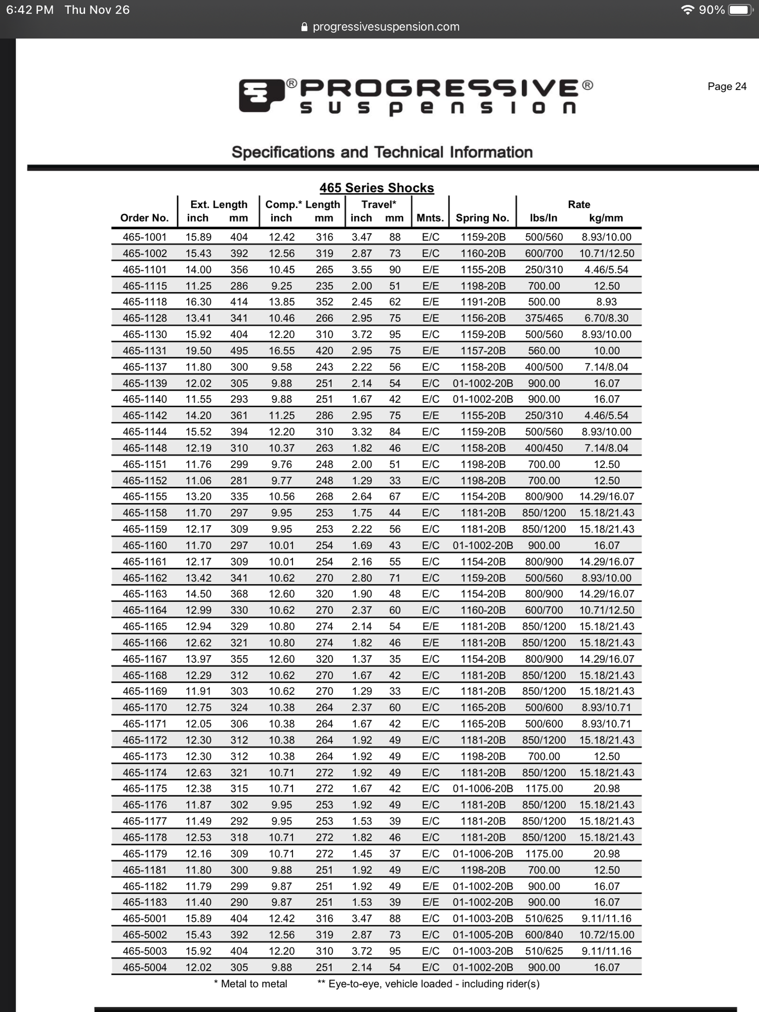

Default Here you go

Originally Posted by Iron lHorse
chart
Odd, I've looked through this chart a few times and I cant find 1186B and 1185B which is the version for the M8 Softails. in 12.6 and 13.1 inch respectively.
I just went back to the site to see if they had a chart just for the HD softails . Nothing
