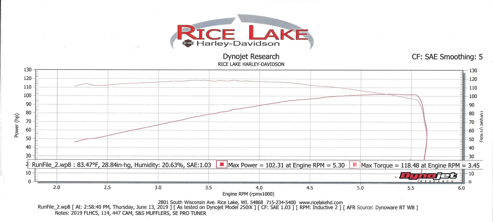

I recommend that you look at the TTS 100 camshaft. It is great at lower rpms and is less sensitive to exhaust systems. I have it in my bike now with the H-D wide band automatic tuning module and it runs fantastic. Lots of info in the thread linked in my signature pic.
Now you throw wrench in my whole situation 🤣. Yes I remember your dyno chart and yes it was insane. Would you mind to share exactly what your whole engine set up is? I was actually hoping to replicate your set up as much as I can as remember this torque was flat as the table on yours. Not sure if FuelMoto can accommodate this cam as part of their install mit but I am asking now. Would you mind to repost your dyno chart just so I can get the idea?
The dyno chart I have is with the H-D torque cam. I had that installed by the dealer before I took delivery of the bike. 12,000 miles later I was less worried about the warranty and wanted to put in the new upgraded oil pump so I switched cams to the TTS-100 at the same time. It is an amazing cam for smooth and powerful low end torque with great throttle response.
