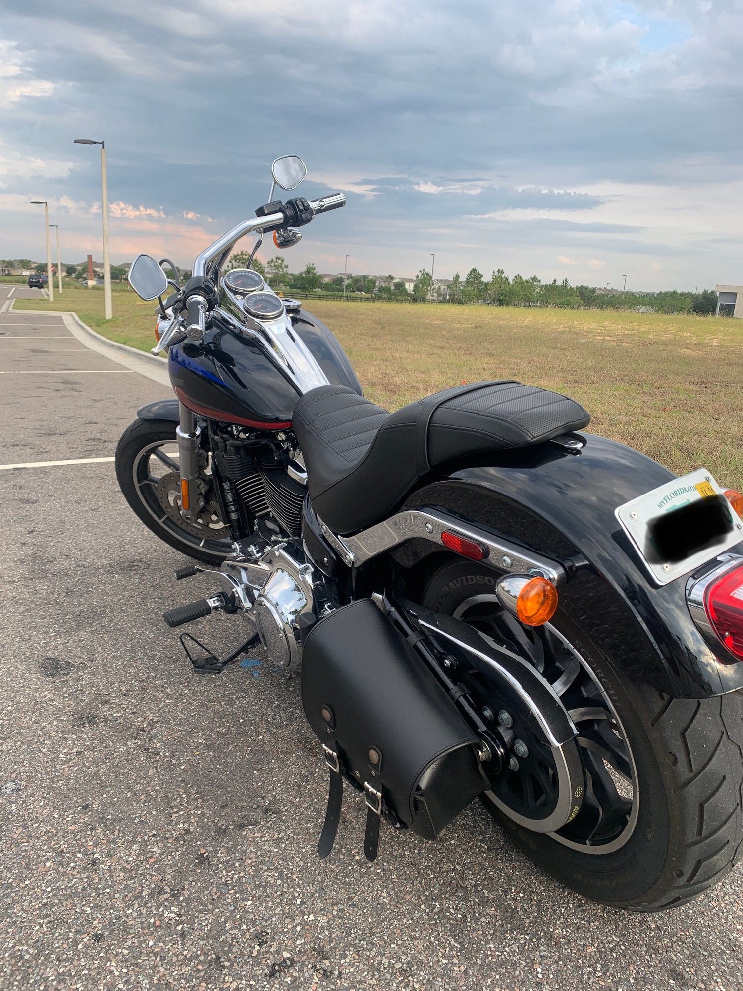

Well, finally got it done and it was a PITA, but well worth it. It looks better and rides better! Topped the off with some Defiance grips too.

Originally Posted by SVTII
Excellent post! I figured that was the case after I posted and thought about it for a while. Much appreciated info! I have some time off in a couple of weeks so I’ll tackle it then. Thanks a million!
Looks nice on a slim. For myself not sure for the Fat Boy: Ape or T Bars…
Hell yeah, looks good. I love the hell out of that Defiance collection too, all those pieces look like hot rod perfection.

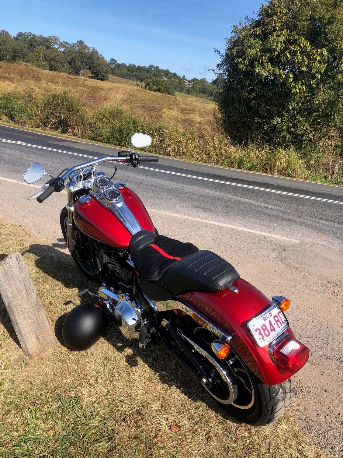

Thanks Mike Your wisdom helped me as well with my install took me 8hrs but easy as job nice and slow , just take photos for reference with the de pinning of wires that helped.
Street Slammers
