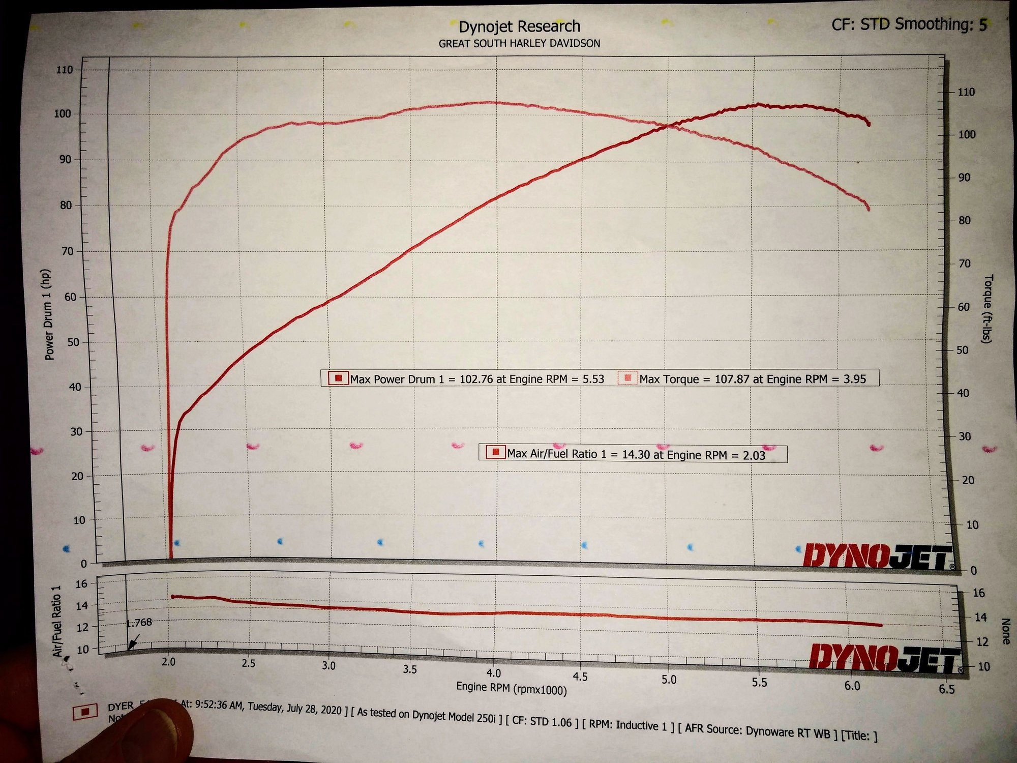

Hi. I look at it this way.
A stage 2 will maximize your current engine's setup: exhaust and intake with a cam install and a proper tune.
Stage 3 is a displacement upgrade.
Stage 4 is a ported polished head upgrade with throttle body and injector upgrade. After a stage 1&2 I had the S&S 106 hot set installed.
I went from a well tuned 96 ci engine with 101 pounds of torque and 95 hp to a 106 ci wit 108 pound of torque and 103hp with a very flat torque response. See Dyno tune graph.
Adding ported and polished heads with a larger throttle body would push it up above 110 pound of torque and 108 hp. The key to any mod is a good tune by a competent Dyno tuner.
I Use a TTS tune interface instead of a piggy back tuner. I'm very pleased with my bike and it's performance.
