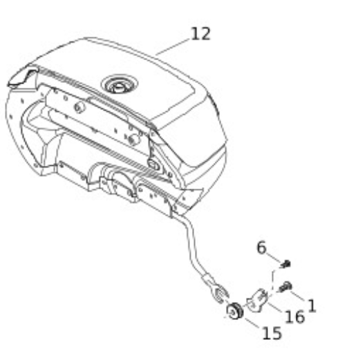

I am sure someone already figured this out just not sure whats the fix. My saddlebags on Heritage rattle where lower arm goes into grove in the frame mount on the bottom. Thing drives me nuts. Whats the fix?

You can probably twist the fork ears with a pliers so they wedges tighter in the groove in the frame mount.

I had both of those problems. The rattling bag brace I wrapped a black plastic coated twist tie around the mount next to the arm. Up front I found it was the fog lamp inner mounting ring, couple pieces of electrical tape around that. Problems solved.

I put a rubber o ring around the saddlebag mount, worked great.

You can try loosening the two mounts inside of the saddlebag, push the bag forward, and retighten the mounts.
Maybe another consideration is over time the grommet deteriorates and may need to be replaced.

any chance for picture of the ears? Not sure where that is?

I snap a rubber band around the mount after installing the bag to “fill” the gap and prevent rattles.

any chance for picture of the fork ears? Not sure where that is?
Bend or twist the fork ears to fit snug in the groove of item 15.
