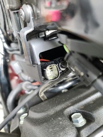

Ive been watching videos. You got it right. 1 bad thing on the new Softails the ges pump connector is up under the tank. Got to pic it up about 8" in the rear to get to it. I think I will set it on wood shims to hold it up to un plug it. Then purge it. The service manual has 3 pages on it, and it jumps back and forth 🙄
I haven’t figured out how to hold the tank up with one hand and fish blindly under the tank to unplug the connector with the other hand. Also, there’s a vent line that has to be unplugged. I can see it but I can’t reach it.
Try loosening up the front tank bolt, remove the rear tank bolt. Then lift the rear part of the tank high enough to place a small piece of 2X4 under the rear part of the tank to hold it up. Disconnect the connector and hoses.
Remove the 2X4, remove the front tank bolt and take the tank off.
Hopes this helps.
I used a scrap piece of 2x4 to hold the rear of the tank up. Also, don't forget that electrical connector under there.

I used an empty water bottle to hold up the rear of the tank while disconnecting the vent and fuel pump connector on my 2018 Sport Glide. Worked like a charm!
