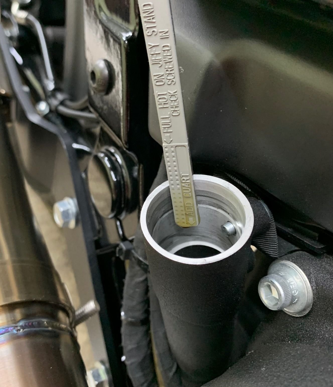

At what level do you keep your oil?

The narrowest part of the line is same size as diameter of the s&s canal for venting but I have to admit you make me thinking now as you might be right maybe I should bump up the line diameter as at some point both of these lines go to a T so maybe in fact I created restriction on the flow at the junction somehow as this would explain my gasket leak if pressure is too much. Crankcase vent is just extra so I am not that concerned about it. I run 3/4 oil normally now I do 1/2 even.
