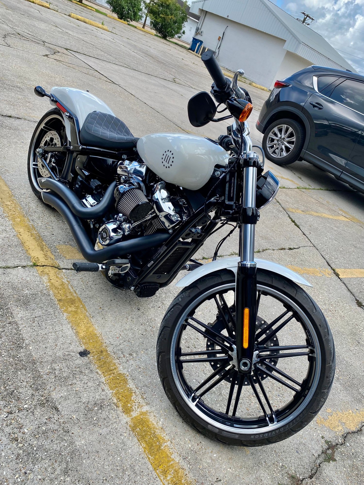

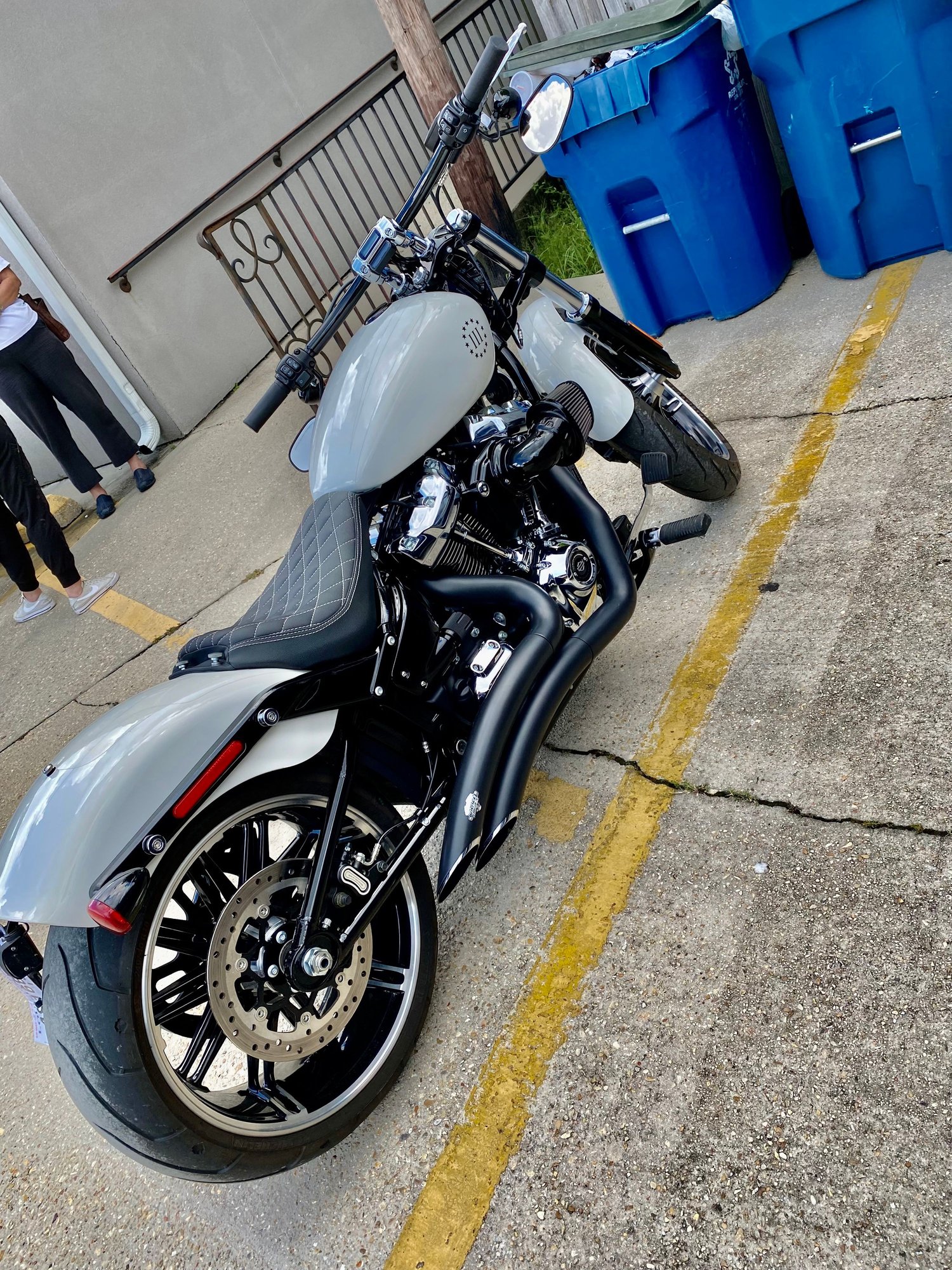

I am 23 and just bought my first Harley. Bought used from the local dealership with stage one already installed (2 into 2 big radius V&H), not 100% sure abt the air cleaner, I think its the 90 deg Arlen ness. I'm also not sure what tuner was used on the bike.. I've looked a couple times (didn't pull anything but the side covers off) and haven't seen a tuner plugged in there still. But i was told that it was tuned. No running issues at all, this thing is a beast!
I'm looking to go with the S&S 475C cam chest kit, that has the cam, inner bearing, adj. pushrods, tappet cuffs, chain tensioner, oil pump, cam chest, and lifters ($1450). Then get a powervision to try and tune with. Not really looking to dyno it.
I've heard that the big radius open pipes can cause some problems as far as tuning goes with this cam. I specifically want this cam bc of the sound, i love it. Performance is just a +. Especially with the big radius pipes, they sound wickeddd. I don't care how loud it will be, and I don't care abt dyno numbers, this thing is already fast as hell so anything extra is just icing on the cake.
If anyone could shine some light on this subject it would be greatly appreciated... Just don't want to run into any unexpected problems when i go to do this upgrade.
