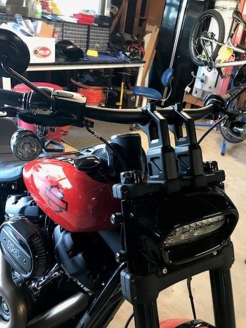

So I installed the Bitchin Seat 3" riser extensions, should have been a dealer installed option honestly. Fitment is perfect and exactly what I wanted for bar fitment. Completely happy.

That's for the bars yea Orange(agent) ? No cable changes needed,Y/N just so next guy that asks if 3 " inch risers will fit a Fatty we know.
Cheers man post up a pic.

Yes they fit perfectly. I loosened the banjo fitting up top just a smidge and rotated the cable forward a bit and then retightened it. Same with the lower fitting nut down on the fork. Loosened it just ever slightly and rotated up as much as I could get away with without it hitting anything. So yes if your bike is a 114, it has abs and no extension cables is needed.

I did the 2.5" CJ Motorsports risers. Just like Orange Thunder I had to loosen the banjo fittings on the lower triple to spin around. I did do a 4" extension on the left turn signal wire as it was stretched and kept coming out of the connector under the tank.
