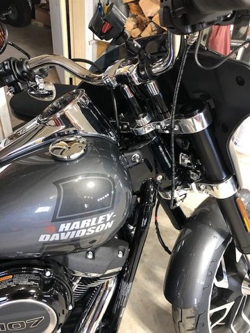

I searched High and Low and seems that all the HD pullbacks are on backorder. Decided to whip up a test set of extensions, to use until they become available. I had some 1.25" stock, cut a pair to 2" each center bored them 1/2" sanded and painted. About 2 hours of messing around but came out pretty well. I flipped the clutch cable in front of the bars and all other wires are fine. In fact another 1/2" - 3/4" of rise should work,( just a guess.?)
Any way went out for a test spin and the 2" rise feels much better on my lower back.
Just shop parts laying around vs $192 for now!
It was nice to retain the Attractive HD top clamp as well.
