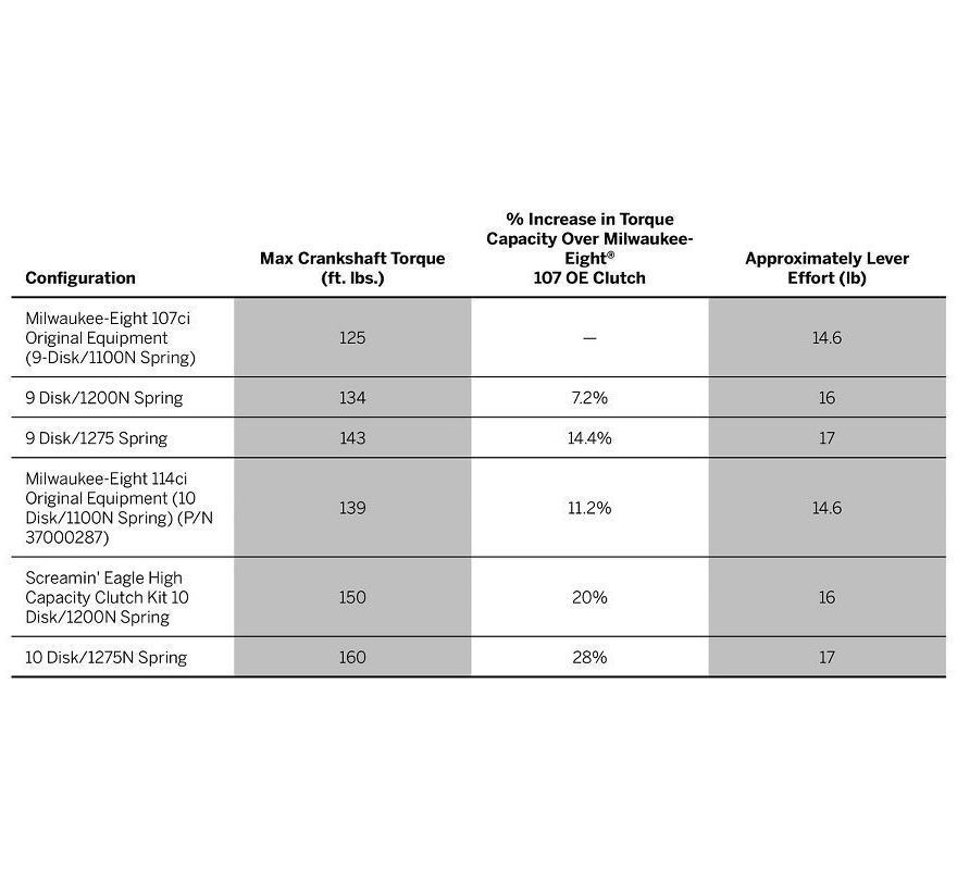

Would you happen to know the spring rating on the stock clutch? I plan on leaving this 114 stock.

I found the answer in the Rekluse instruction guide - approx 135 ft lbs is the answer, which is right at their extra light spring rate.
This might be the ideal setup for my wife.
