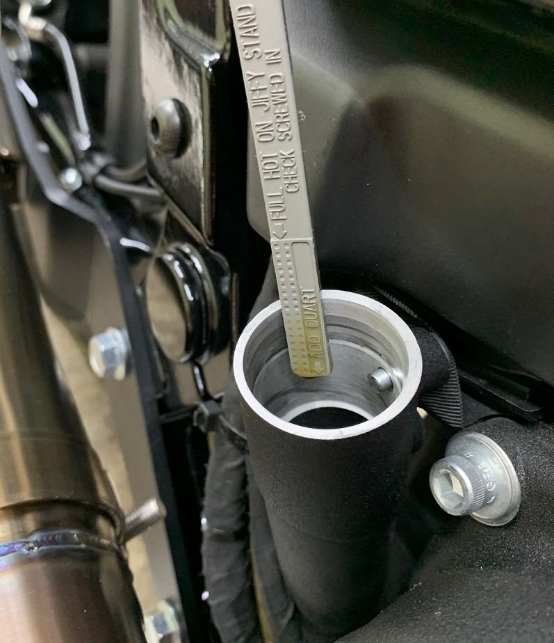

Safe oil operating level as measured on the dip stick is between full and add.
This picture shows my hot oil level about two dots below where I usually keep it. No oil in air filter when running the stock breather system.

Thanks for the input guys. I ended up taking another 2oz out of the bike after a cold check this morning. It was still ever so slightly over half.
I think the bike should be good. I'll be pulling off the air filter later to check how much, if any, oil has been spit into it.
