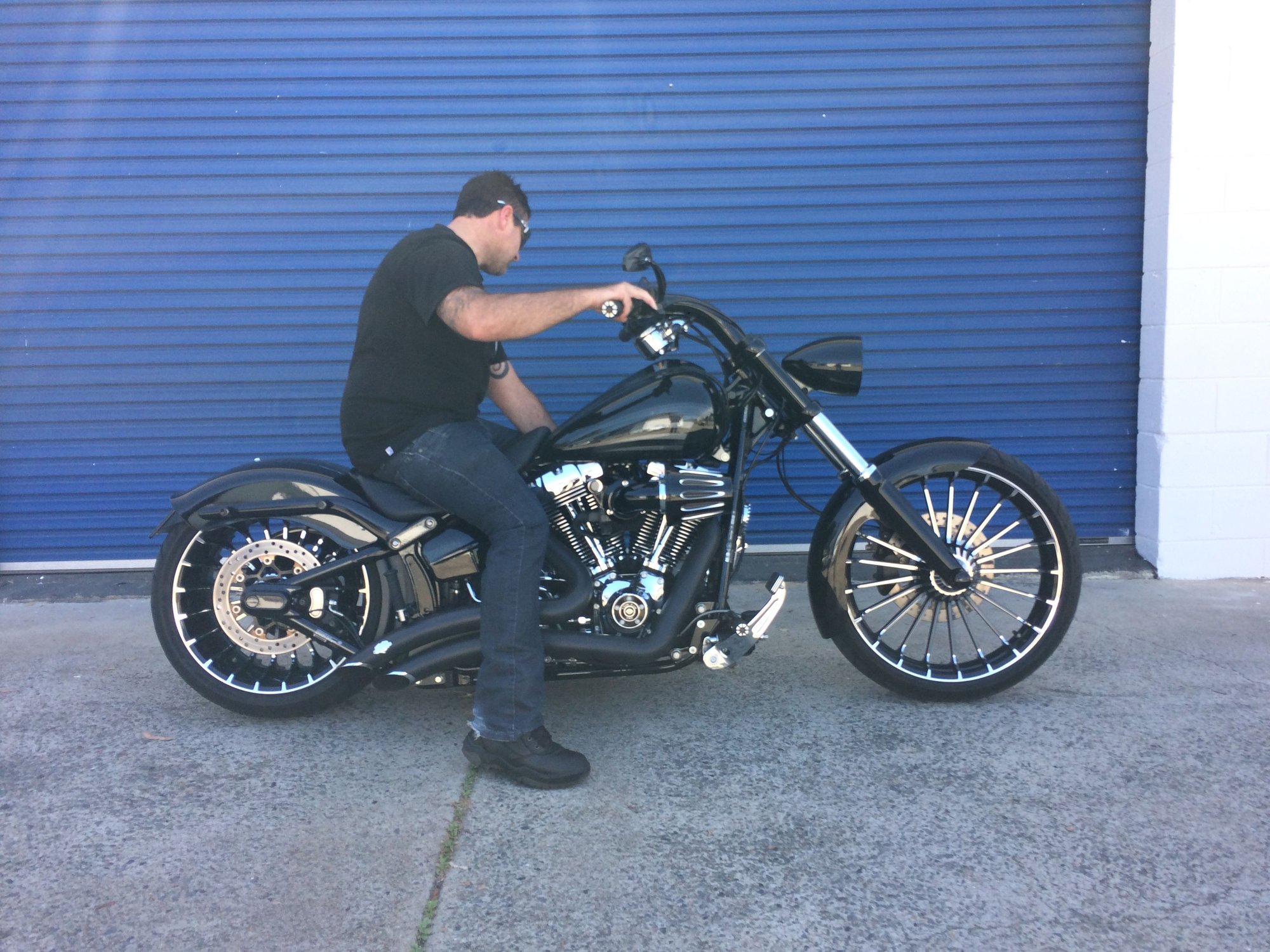

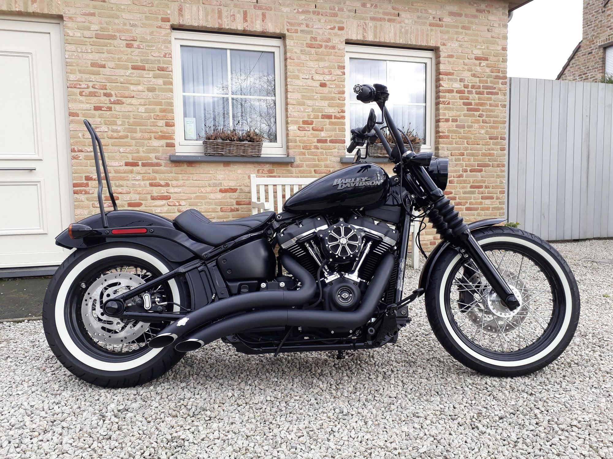

I have them on my 2016 FXSB and on my 2019 FXBB, what I do find is that on the M8 platform the exhaust is more outwards so that it hits the ground faster in a fast turn, I have already pushed the bottom pipe against the asphalt a few times

I love both of those... Seen them a few times cruising around the forum! They kind of answer my question! I appreciate the pics!

Never was an option, did this myself

I had powder coated them first but it just kept getting gray and dull. After cooling the exhaust you could polish it away and it became nice and shiny again. But last summer I stood in a traffic jam for too long and at the front exhaust it was really
just melted away, the powder coat I mean . I then completely sandblasted the heat shields and painted it with MIPA-therm Heat Resistant Paint 800°c / 1472℉ and the result is just as beautiful. Initially I wanted to go for black chrome, but the
