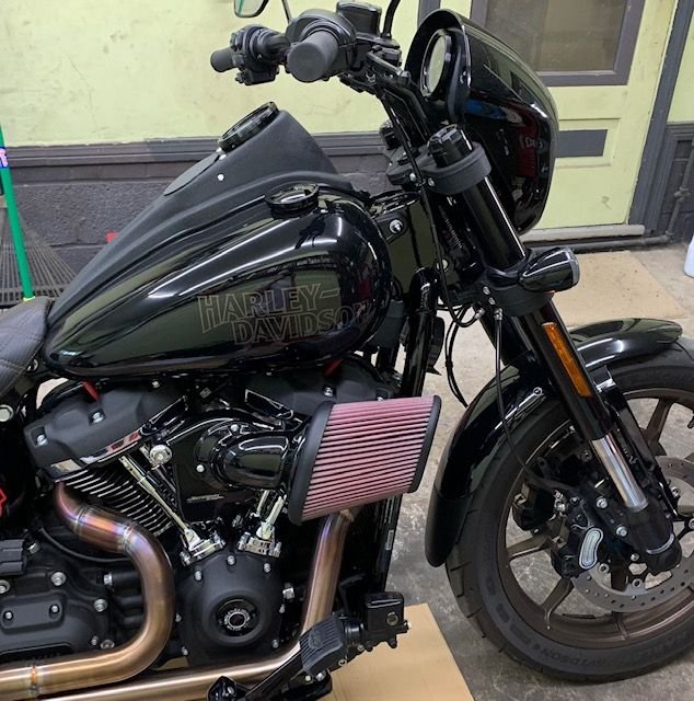

Old Jun 17, 2022 | 03:54 PM
OldMike's Avatar
OldMike
Joined: Feb 2009
Posts: 5,642
Likes: 1,985
From: Cleveland Zoo
With the stock Ventilator I found several filter element choices: Stock, K&N stock replacement, K&N E-3988 and the STFU kit. Oh, and the Extreme Ventilator (not pictured).
Running this one now with the 131", supposed to flow the most for a SE air cleaner.
