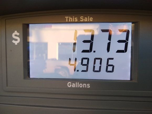

The tank doesn't have a petcock that you swap over for "reserve".
It holds 5 gallons. The "low fuel" light comes on when the fuel level dips to around 1.4 gallons left. When that "low fuel" light is on, you're using up the "reserve" gas, and you had better refill within the next 40-60 miles or you will run out
As for how much a Harley Softail 5-gallon tank will hold, I once ran mine down to about 5 miles after the gauge said "LOW" (meaning about 5 miles away from bone dry) and then refilled. This shows the refill:
(That was just a couple of years ago, and gas was $2.79/gallon!)

Note: it isn't easy to get the tank to hold that much. If I just stick the nozzle in an empty tank and let it fill up, it will usually stop at around 4 gallons, with gas visible in the filler neck. But if you wait a few seconds, the gas will trickle down into various nooks and crannies and the filler neck will drain down some. Also, if it isn't draining down, you can usually "burp" some air out of the tank by jostling the bike a bit side to side. This will frequently result in some air bubbles popping out, and the fuel level dropping as the gas moves in to where the air bubbles were. I have been able to add up to 3/4 of a gallon extra using these techniques, and that's how I was able to get the 4.9 gallons shown in this picture (and note, the tank wasn't 100% empty during this refill, I probably still had about 5 miles of range left (or about 1/10 of a gallon).
So yes, there's about five usable gallons possible. But it's a bit of a pain in the patootie to get full use of all five gallons. Getting a usable 4 is very easy, getting all five takes some work.
