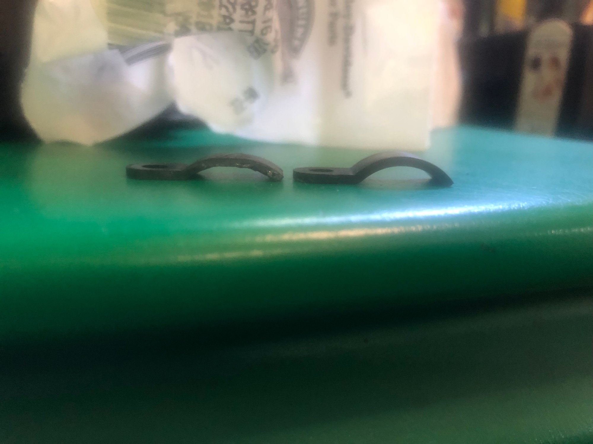

Called my dealer and got a 12200140 part number. Every one I see on line says it won’t fit my bike and has a 45081-26 part number, the 12200140 does not come up on line. I know Harley likes to change part number’s for no reason sometimes. I guess I will try the other dealer’s and order one if no luck. I replaced one on my wide glide years back and I think it was steel. Picked it up from a little shop down the road. The plastic one in my m8 has definitely lost its arch.

4$ fix. 2 years and this is my first problem. This is bull ****. 😂 love this machine.
