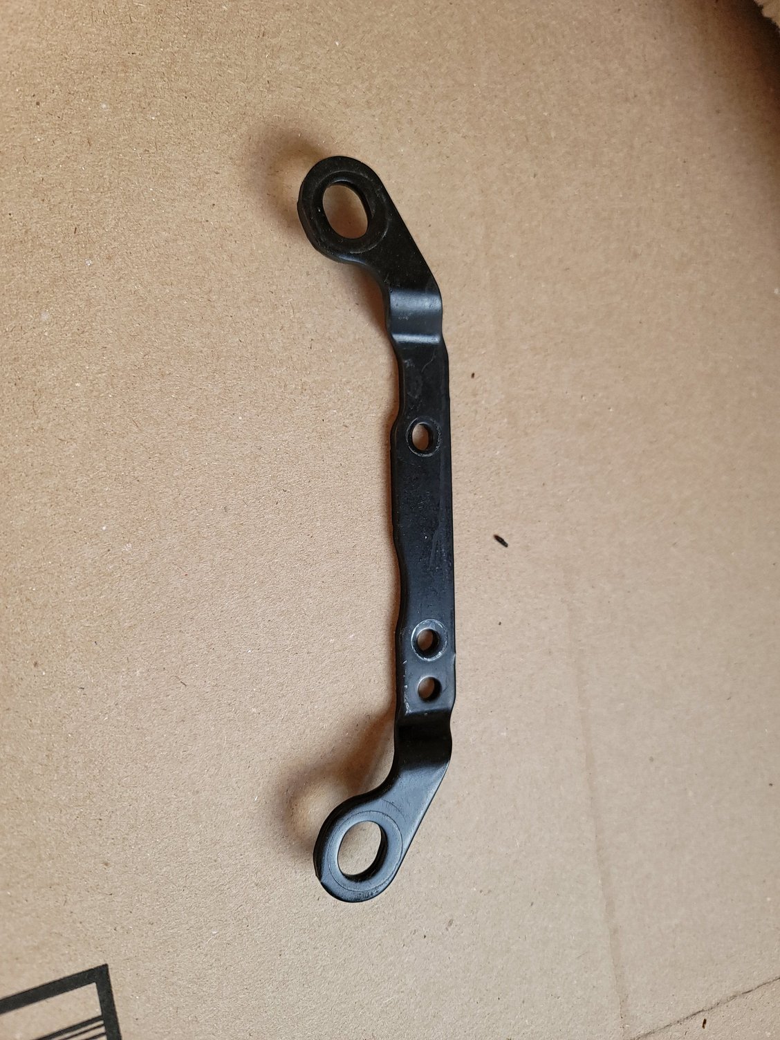

I replaced my screaming eagle heavy breather with a V&H V02 intake. My heavy breather did not move when installed.
Now I can move the V02 up and down just like in this video when there is no air cleaner installed.
Is this normal? Anyone know what to tighten. I could not really see a bolt to turn??

Did you use new manifold seals or possibly forget to put them in? No, it should not move like that, movement = air leak.

Your missing a bracket

Do you have a part number or what that bracket is called?

Nope....Just took off the old breather and installed the new one with the parts it cam with.

Is the HD part number 27200041? Manifold/Throttle Body Bracket?

Yo,
How did you resolve this issue? And did you really have a leak?
The exact same thing has happened to me when i removed my original breather. It was really stuck after i'd removed all of the screws. When i finally got it off (i had to pull really hard) part of the gasket was stuck on the throttle body. Once the breather was off i could also move the throttle body and manifold in the same way, up and down like that.
Did you have to get new seals and gaskets and do a complete re-install of the manifold and throttle body?
Thanks!

for the small price of a couple of seals/gaskets yes replace them
