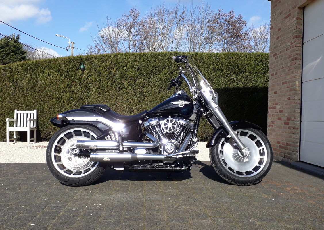

I have the Platinnum Air Suspension on both my FXBB and FLFB, happy with it.

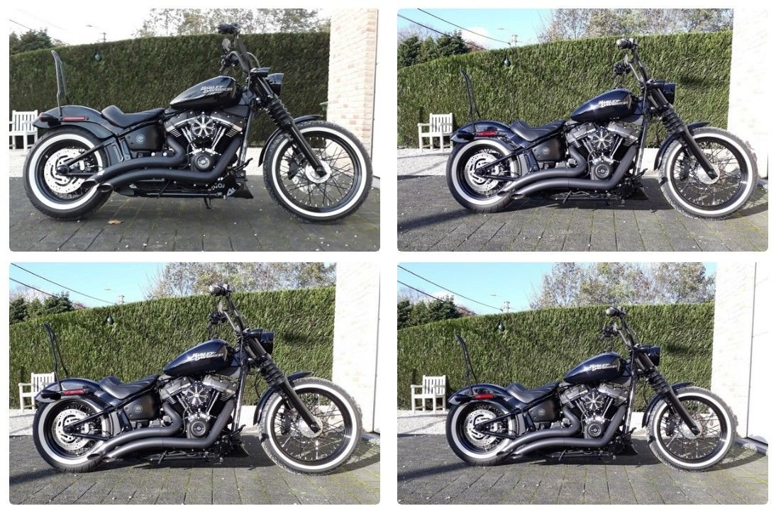

I don't quite understand your question, I also have the Platinum Air Suspension installed on that ( Fat Boy is the FLFB ) Is in the lowest and highest position in the photo.

Yes, no problem at all, same on the FXBB, no alterations done to the sidestand.
