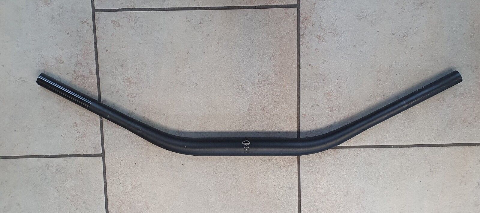

For what it's worth my 2020 Fat Bob 1 1/2" bars are NOT knurled. Here is a random ebay pic. When I adjusted the angle of the bars up, I tightened the bolts in a upper clamp lower clamp sequence crossing them, (Upper Right, Upper left, lower right, lower left) evenly until they felt snug. The gap was equal front to back.
I heard that i did, so you dont use loctite or use a torque spec on the bolts ?

I did use blue loctite on the bolts before tightening. I'm old school and just did a "Tight plus a bit" when tightening them down. Not sure on the correct tightening sequence but the left to right top then left to right bottom with a quarter turn on each until tight felt right. They don't budge at all.
I have since swapped the stock bars to Trask V-Line and those do have the knurling. I also had to use the HD space to go from 1 1/4 to 1 1/2 as I still use the stock risers.
