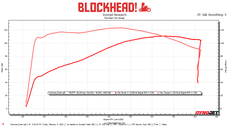

Originally Posted by NZLowrider
Was your Lowrider ST tuned on dyno also?
Yes, absolutely. Techno Research Direct Link and tuned by probably the best tuner here in the UK.
I am quite pleased with the result. As stated above, the 117 has the CVO cam in which is similar to the SE447, but not the same.
I'll probably do a different cam and either the S&S Stealth or Trask Assault air filter at the same time later this year, then back on the dyno it will go.

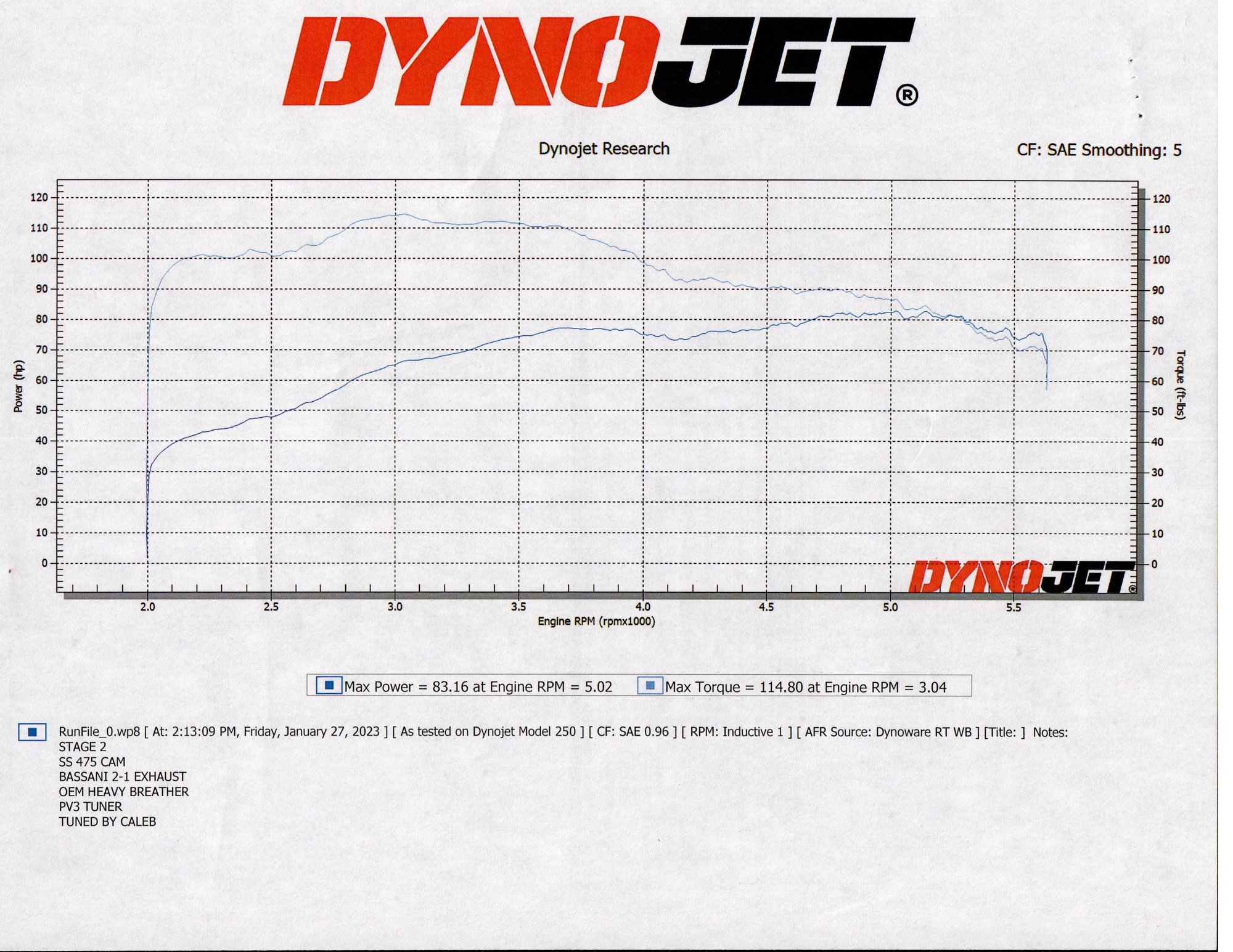

[QUOTE=torque73;21046625]Just got my 22 Fat Bob back from Harley and my dyno numbers aren't looking good. Installed S&S 475C kit, Bassani Ripper 2 into 1 and power vision tune. 83HP and 114TQ. Any ideas?
Something is definitely off !114 with 475 cam? stage 2 your ho #s should be over 100 and torque over 120 dealer did something wrong, you should havenoticed an eye popping difference over stock.

Originally Posted by torque73
Yea, I reserved a motorcycle trailer from uhaul, better safe than sorry. Plus its super loud, my guess because of the tune also. Maybe the combustion process is still happening from all the gas not getting burnt before the exhaust valves starts opening or maybe its lighting off in the pipe I don't know, but its obnoxious lol. 106-108 db at idle right now measured beside the bike.

[QUOTE=Waydel;21051460]
The tuner should of noticed the very low power result and at least should of found out why?

Huge difference between tuners and dyno operators...

Something isn't right here. The 114" with a 475 cam and a DECENT exhaust should be capable of 110-120HP and 115-125 torque. Looks like whoever tuned your bike shouldn't be anywhere near a dyno.....

Found a local shop that has attained much better results. If located in the central Florida area I recommend that you check them out, I found them on YouTube, great folks. Again, thanks for all the replies, help and recommendations, it was definitely the tune from Harley that was the issue.
