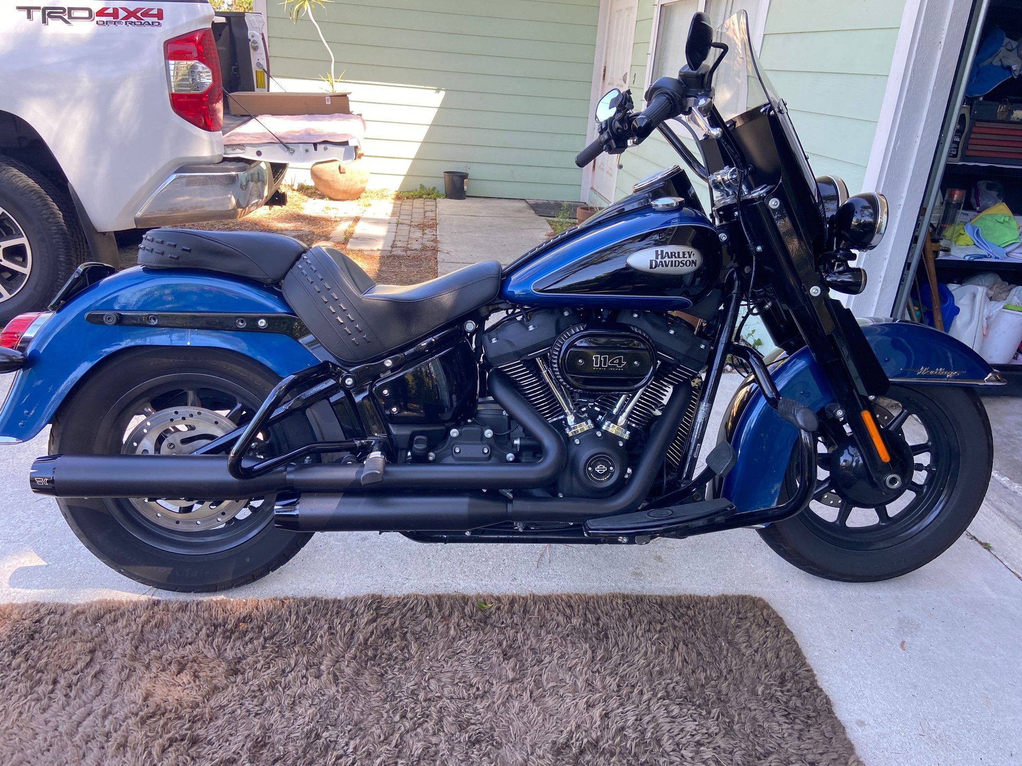

Just so folks can see the khrome Werks slip ons while my saddlebags are off…
Looks good with the cone ends.
It drives me nuts when someone gets a Heritage/Deluxe and swap their slip ons to something with the bell flare end, or the abrupt cut. It looks weird.
The slip ons need those cones at the end on a Heritage, it looks nicer and more fitting to the bike
