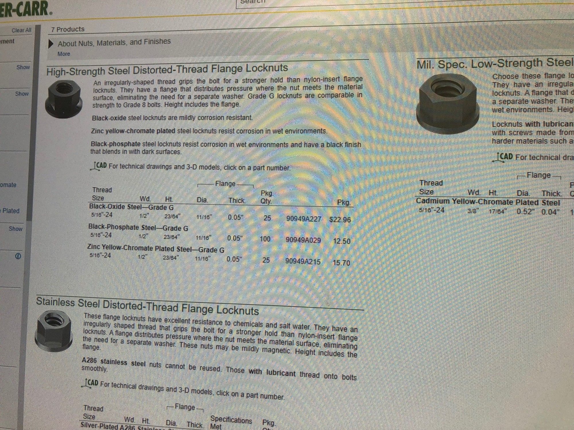

Permatex 27200 Hiigh Temperature Threadlocker Red

Old Jun 27, 2023 | 02:13 PM

Cheers man.I don't think a special nut should be needed though
I don`t either but you been struggling with this for six months...
