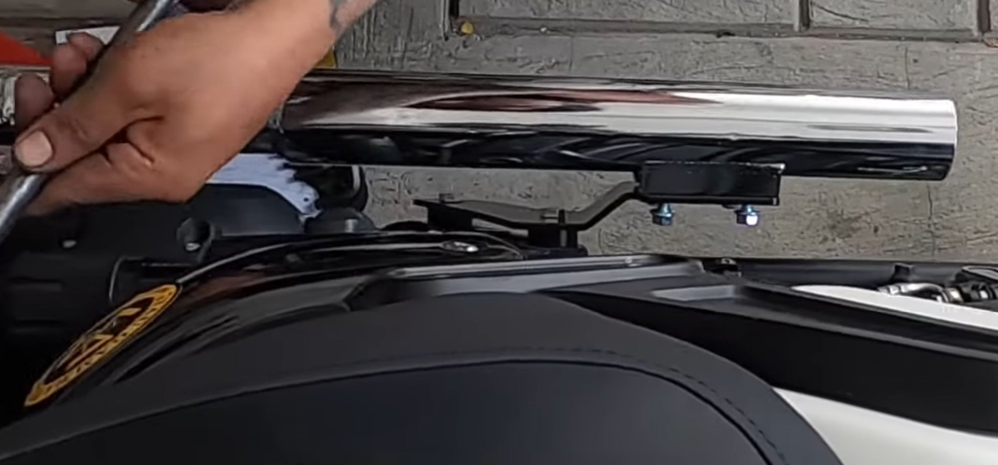

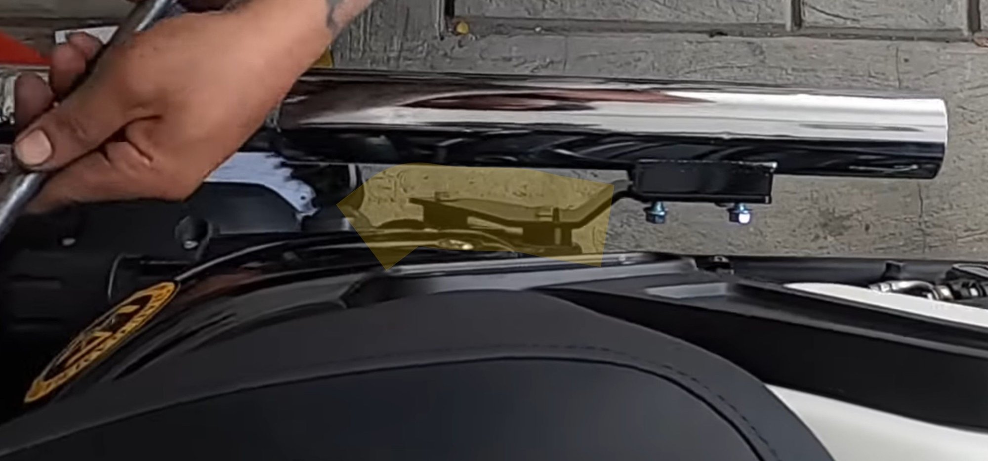

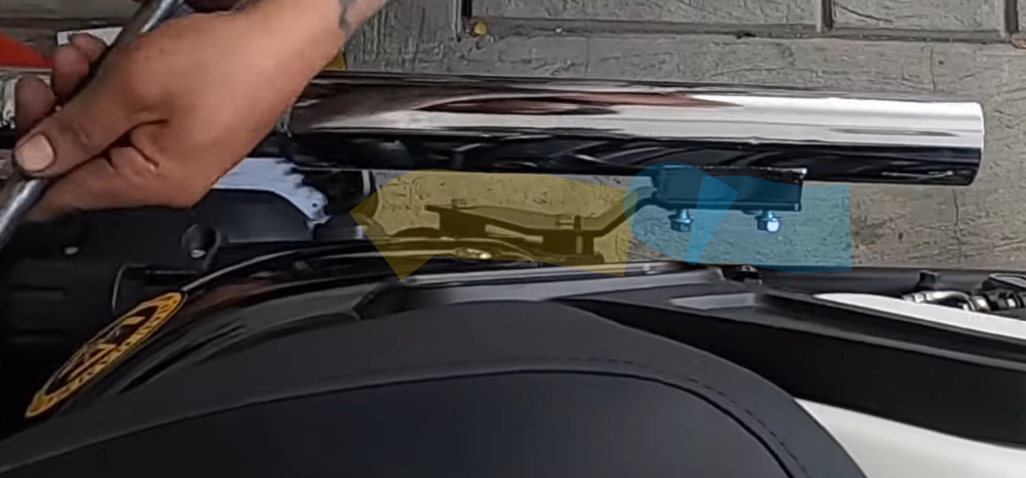

Here's a screenshot of a YouTube vid(after mich digging late last night(early this morning).It shows 2 spacers spacing out the support bracket even more than my set up(my set up doesnt have those 2 round spacers as in the YTscreenshots uploaded here.
If you follow the vance and hines instructions it doesn't reference this.The kit did come with a 'spacer' bracket which is placed between the frame and the support bracket but in the YT screenshot they have it spaced out even more and I think this is what I need to do.
So my bike had a gap in the blue region which closed when the 4 bolts were tightened but this gap and closing of the gap could be 'pulling' the head pipe from the ex ports over time thus causing the flange nuts to loosen.

"they have it spaced out even more and I think this is what I need to do"
Worth a try, if it looks straight viewing from the back of the bike, then you can assume there is no or little pressure.
