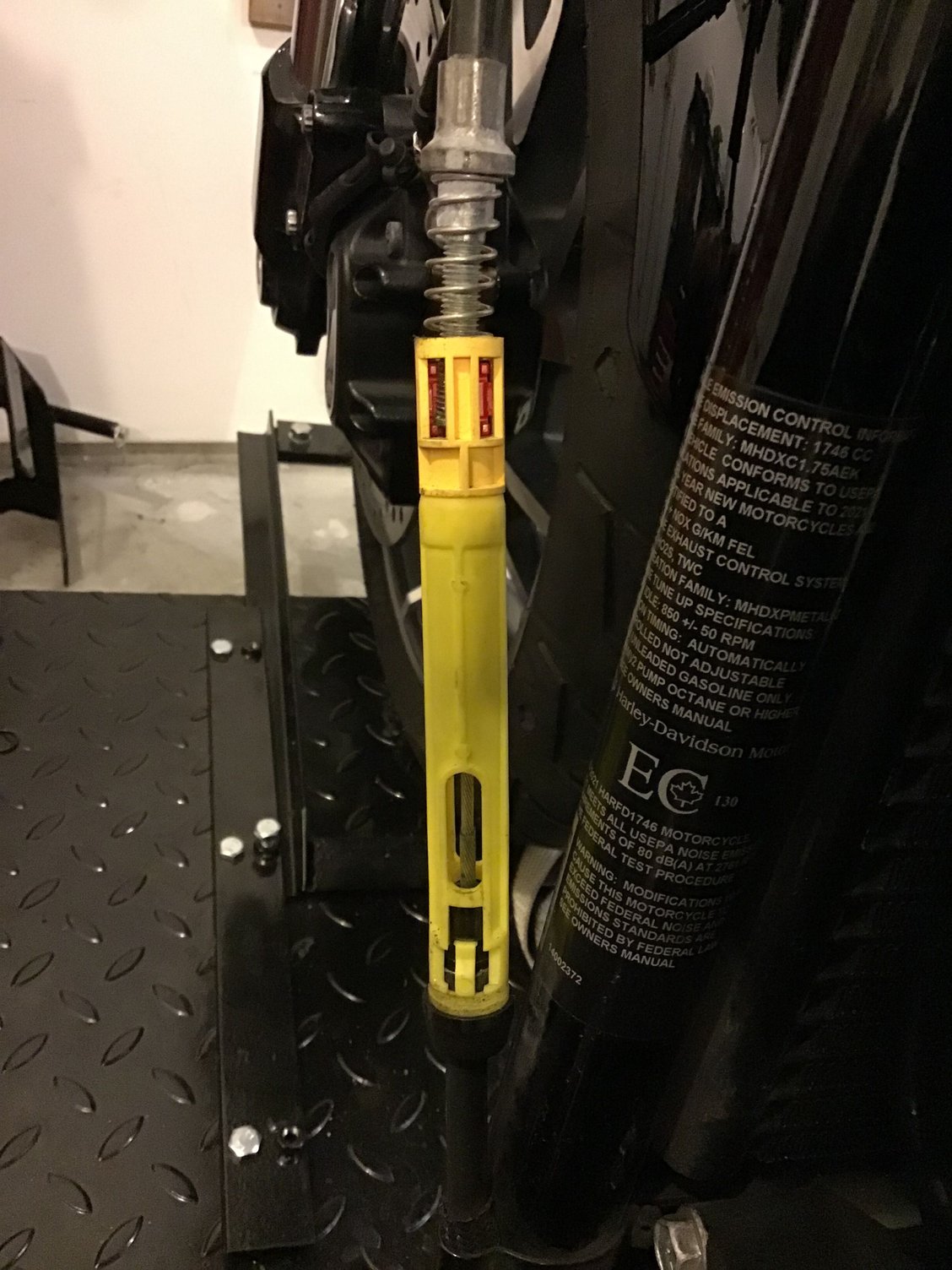

My Sport Glide clutch has been working perfectly, but along with an oil change I decided to lube and adjust the clutch free play. I’ve done this before without issue but this time I have way too much slack in the lower cable and the top cable is beyond its adjustable range.
Here’s a picture of the adjuster, the clutch lever is installed and top cable connected. The bottom cable is too far up inside the yellow sleeve.
What did I do wrong here, and how to fix?

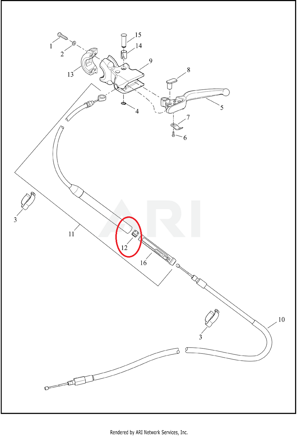

Looks like you are missing a part:
37200395A
CABLE,CL,ADJUSTER BUTTON | cable adjuster
Price: $11.29
I could be wrong though but cannot see it in the picture you posted.

Follow up: I made 2 mistakes.
First, I watched the Delboys video about using the weight of the allen key to determine the spot where the clutch adjuster screw touches the pressure plate. This does appear to be a foolproof way to find that point, then back it off 1/2 turn and torque the locknut. My allen key is quite a bit shorter than the one shown in the video, about half that length, so much lighter and it found a tight spot in the threads long before the setscrew touched the clutch. So I had way too much free play in the bottom cable.
Second, as Coolbreeze suggested above, the plastic clip is not visible in my photo. It is there but pushed back to the release position and it should have been pushed in to lock the top cable spring in the compressed position. Doing that pushed the bottom cable down to where it should be.
Silly mistakes due to doing this work after a long tiring day. Fresh start this morning and it all became clear! All back together and enjoyed a cool 200 km ride this afternoon.
