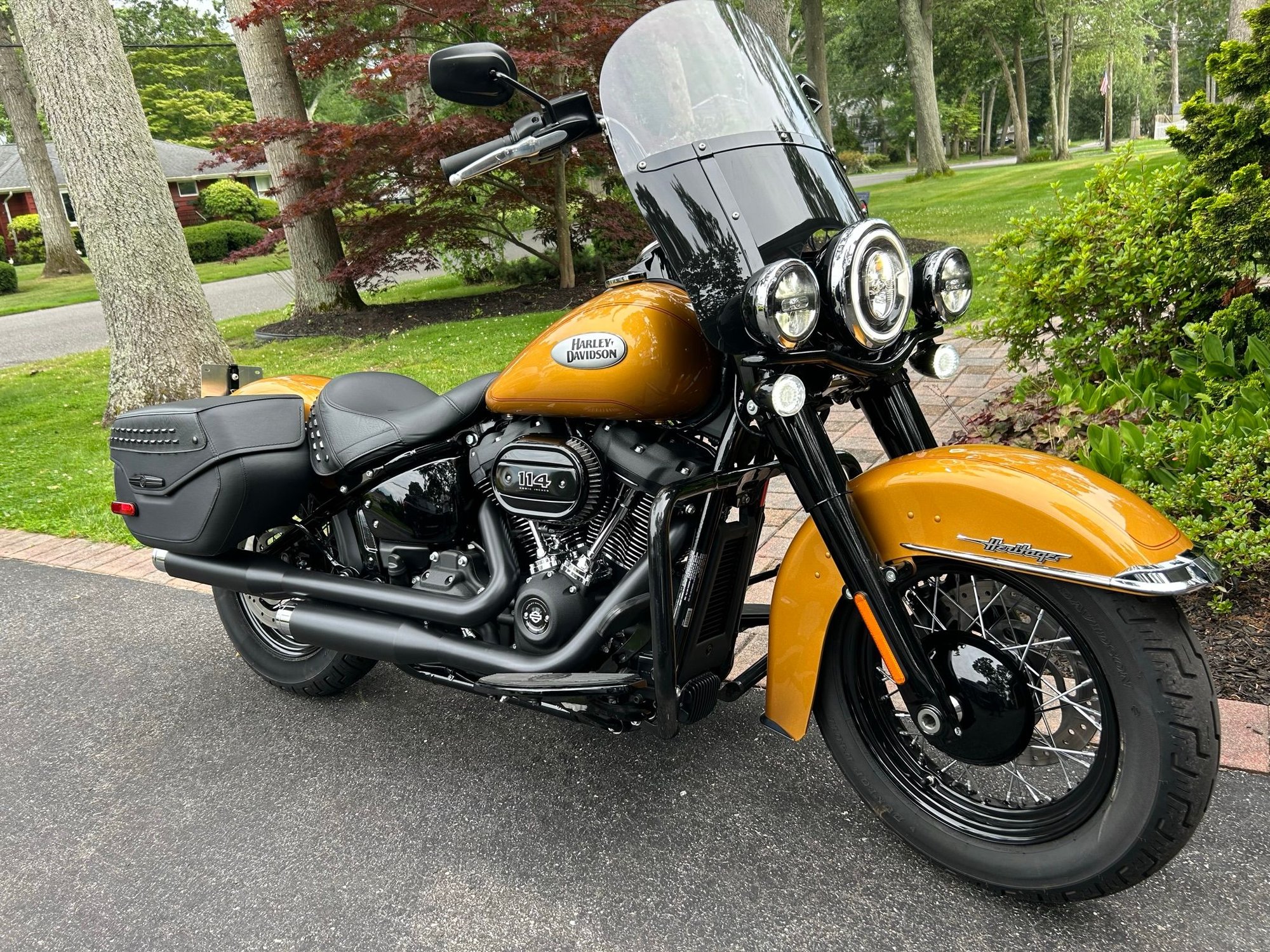

I recently purchased a 22 Heritage and plan on installing some slip Ons. The bike has approx 2200 miles on it and I’m wondering if it is necessary to change the exhaust gaskets.

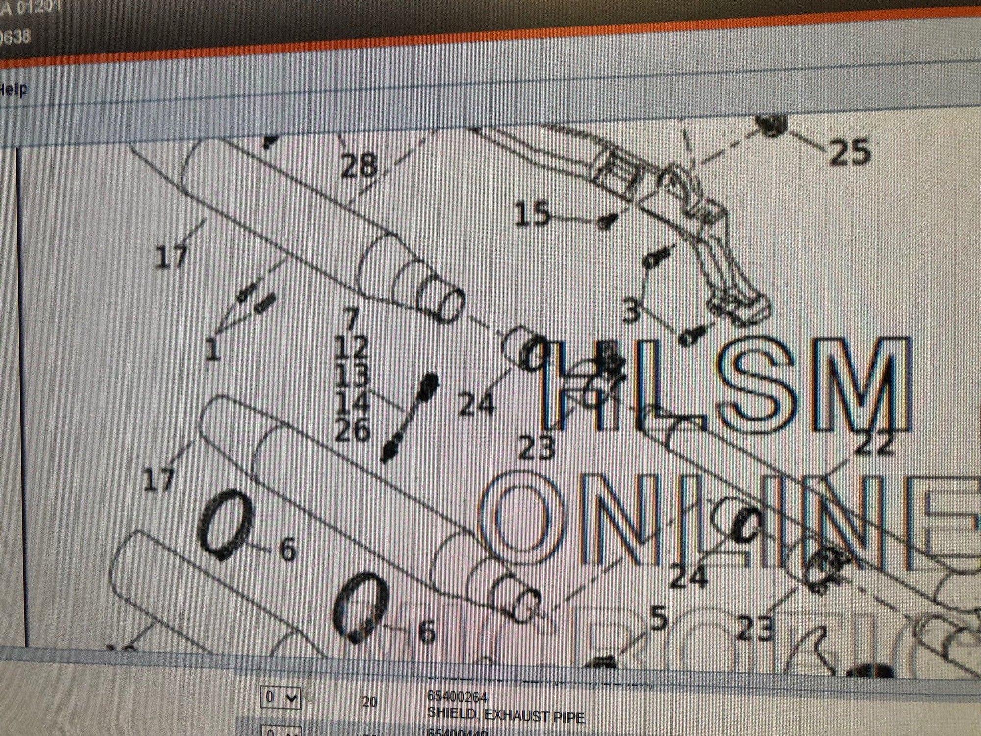

Originally Posted by Glenn Gorman
You have gaskets with slip-on mufflers? I've done a few slip-on mufflers over the years and never saw one with gaskets.
You have now, see item #24
