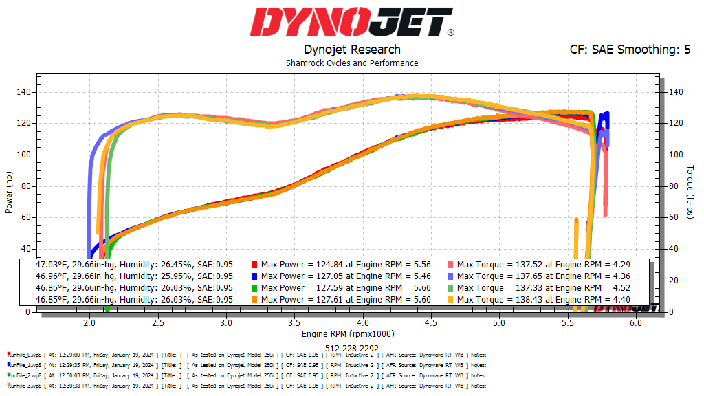

Talking hot damn!
Dyno guy just sent me this.....
S&S 475 cam, Fuel Moto CNC ported intake manifold w/5.5 g/sec injectors, SP Concepts Lane Splitter exhaust, S&S stealth air cleaner, tuned by Nick @ Shamrock Cycles in Round Rock Texas. Bike will be ready to pick up mid week, hopefully the weather cooperates

What bike is this on? The 2020 FXLRS?

2023 Low Rider ST

OEM 55mm throttle body or 64mm?

OEM 55mm

well, you just convinced me to sell my 30/30 cam and go for the F35a like i originally wanted. I am planning on doing a 128-130 kit real soon, and been rethinking cams.
Decent numbers for a drop in 117 cam.

Congratulations on an awesome build. The mechanic at my local dealer tells me he gets similar numbers…120 HP and 140 Tq. in 117s with the 475, a good pipe and Dyno Vision when he tunes. I am planning on going that way with my 2023 Breakout as soon as it is broke in. I just need to figure out the pipes situation. Thanks for posting your dyno and build info.
