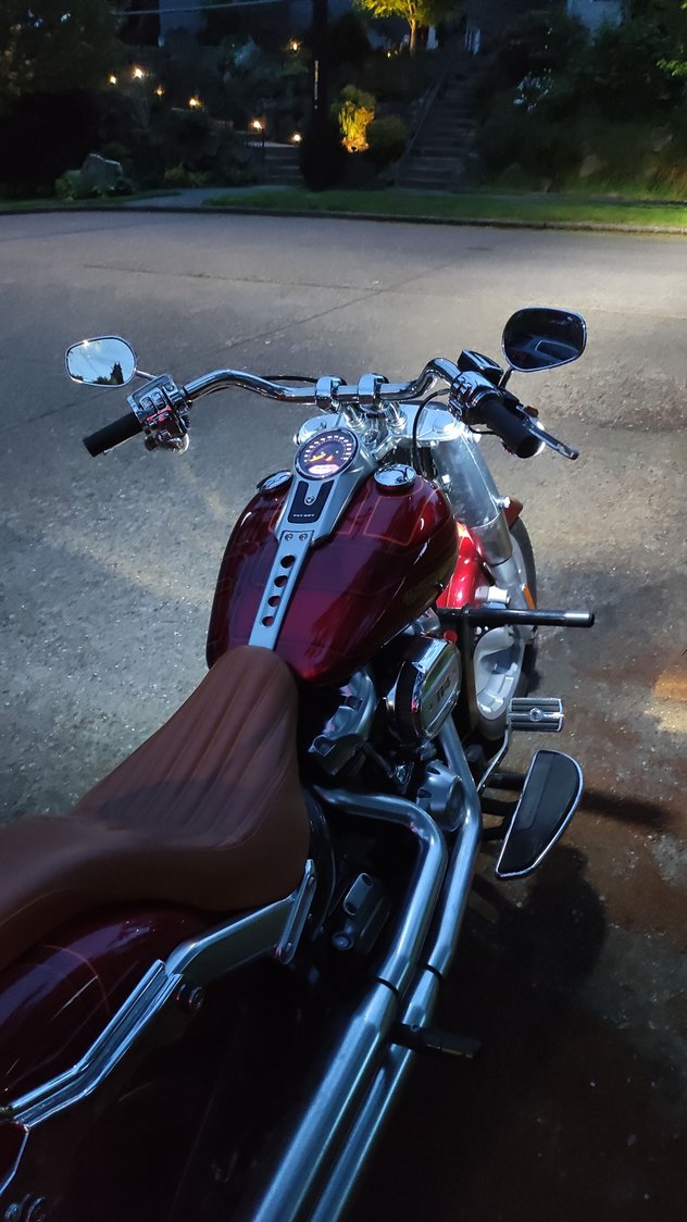

Rogue Rider Industries 1157(Sigz V2 Black Label) Inserts for the Front do exactly this.
This is EXACTLY why I got them for my bike.
I still have them on my bike just with deep dish bezels instead now. Here's a good view of them.
