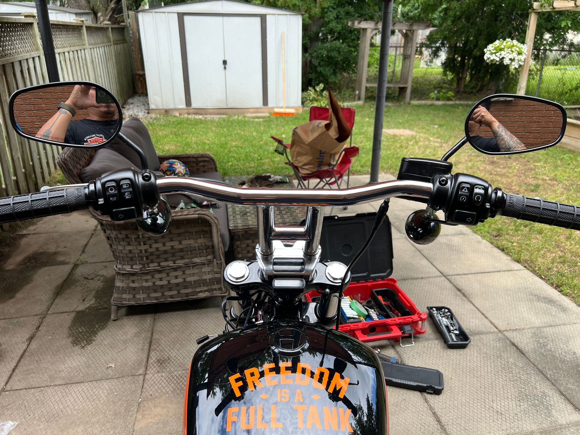

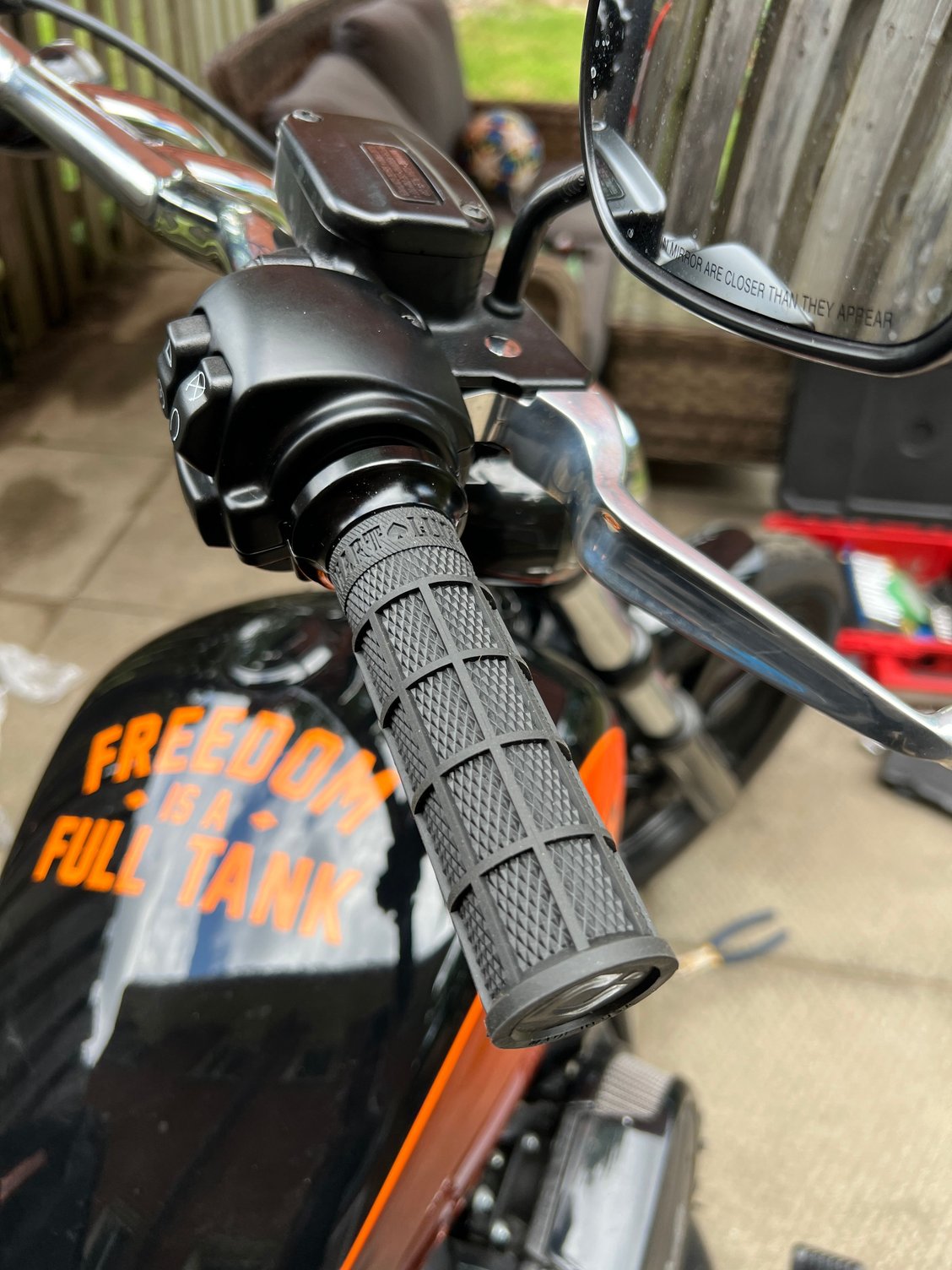

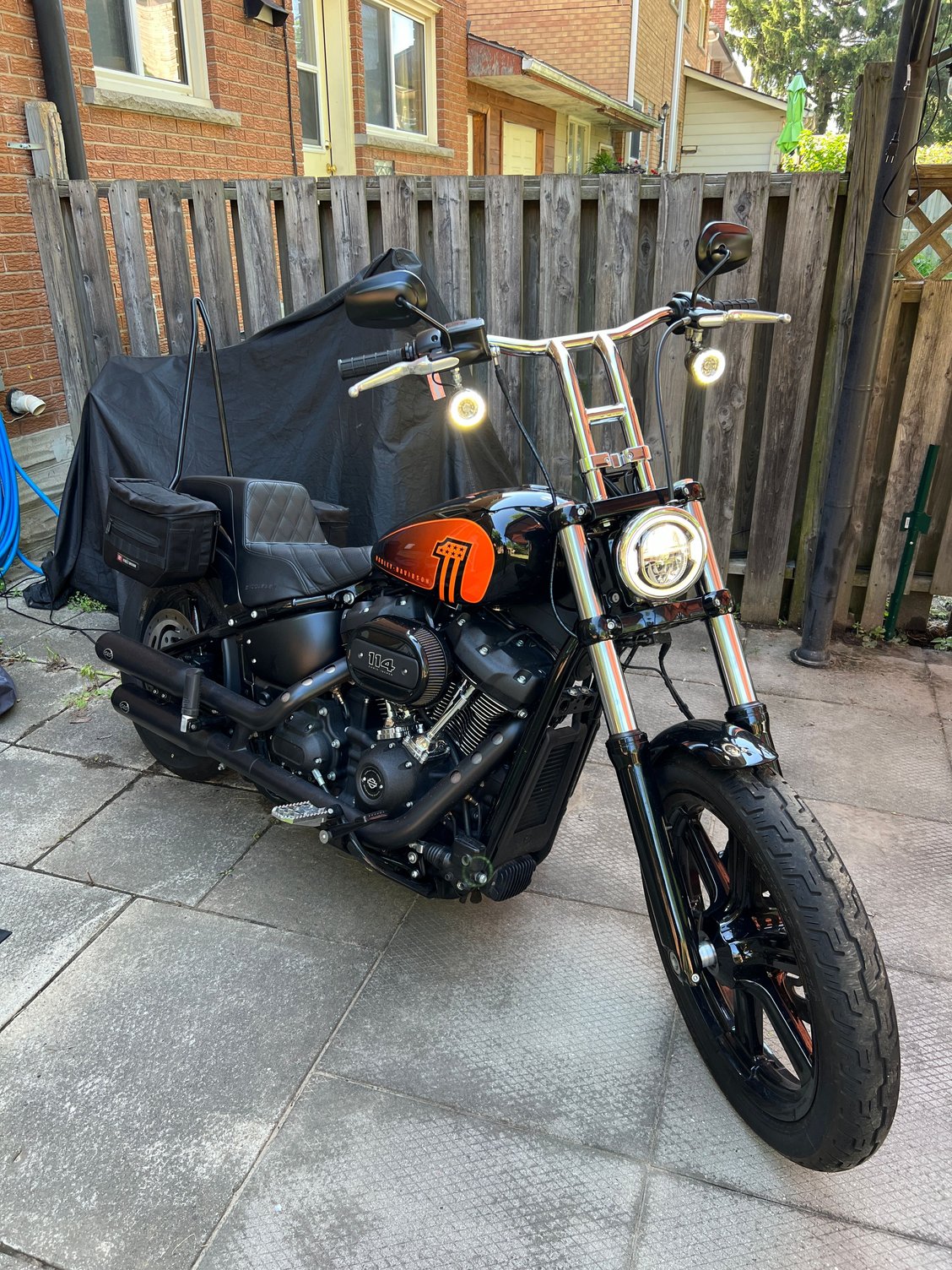

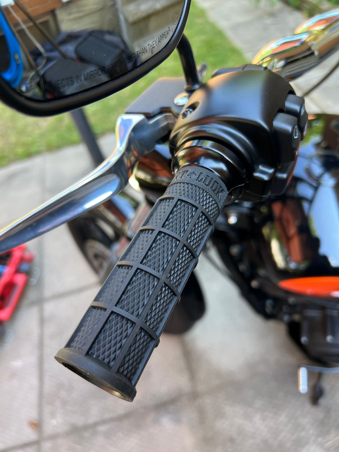

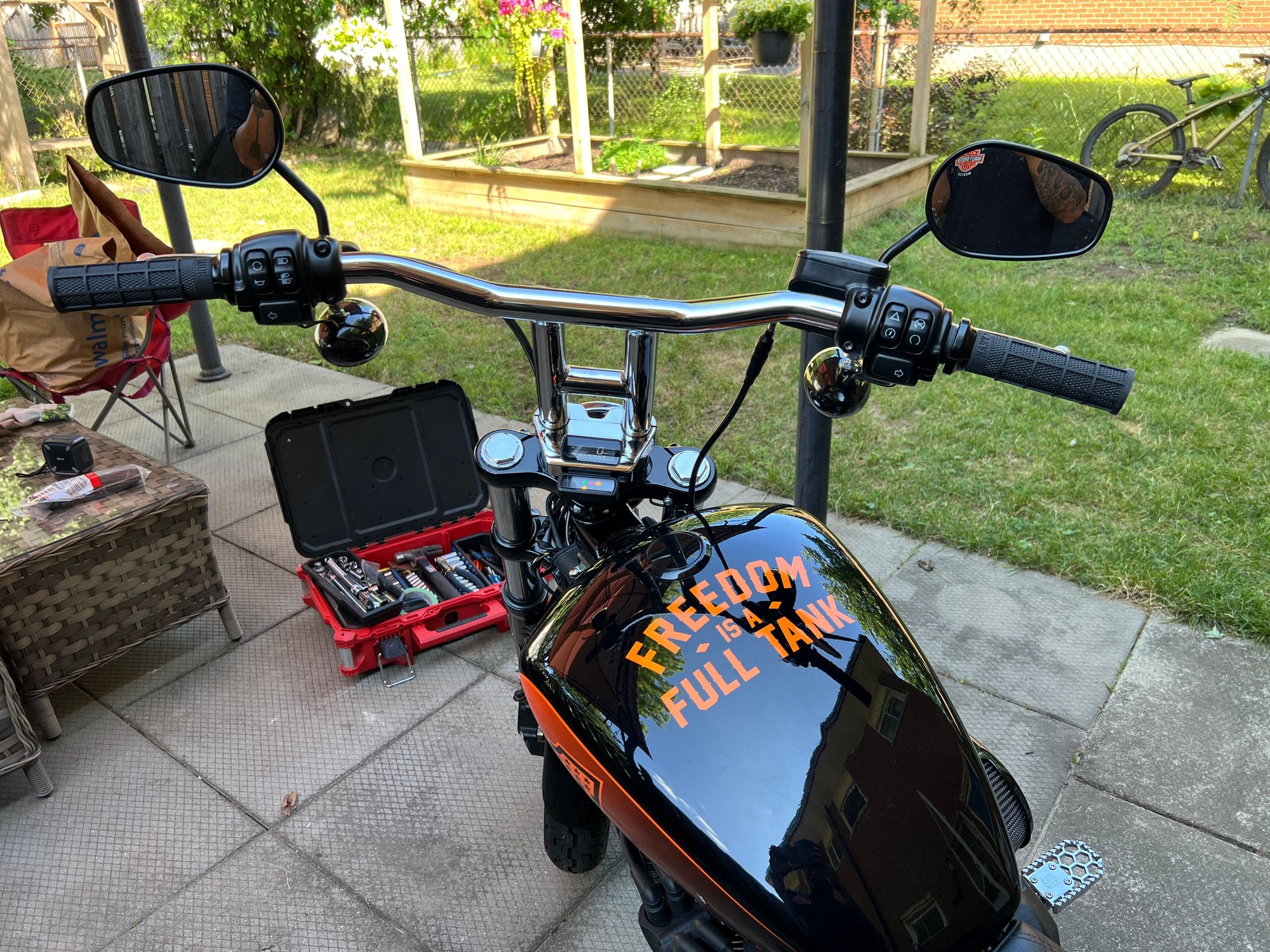

Got caught up in all the moving tasks and unpacking but two weeks later I finally found some time to complete my new bar setup.
Biltwell Tyson XL pullback 14”
Biltwell gauge mount
ODI vtwin lock on grips
no extensions of any wires, brake line or clutch cable needed
Please ignore how dirty she is. It rained on the drive to the new house and it was in an open trailer and haven’t had time to wash her let alone ride until today. She’s gonna get washed this weekend after some exploration through the new neighborhood.

much appreciated, found a quick tutorial on YT and got it all cleared up and went for a proper test ride for a couple hours yesterday. Much better ergos and achieved exactly what I hope for with the bars being more narrow and pulled back closer to me. Not leaning forward anymore and have a bend to my arms now and can really lean into the back of the step up seat.

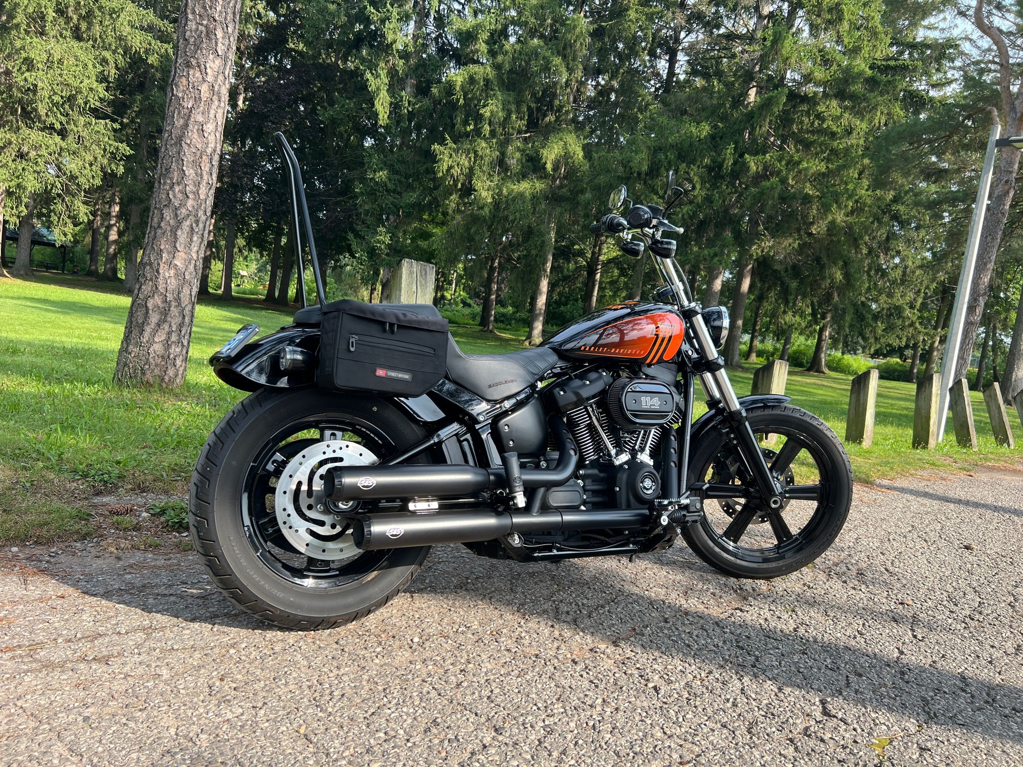

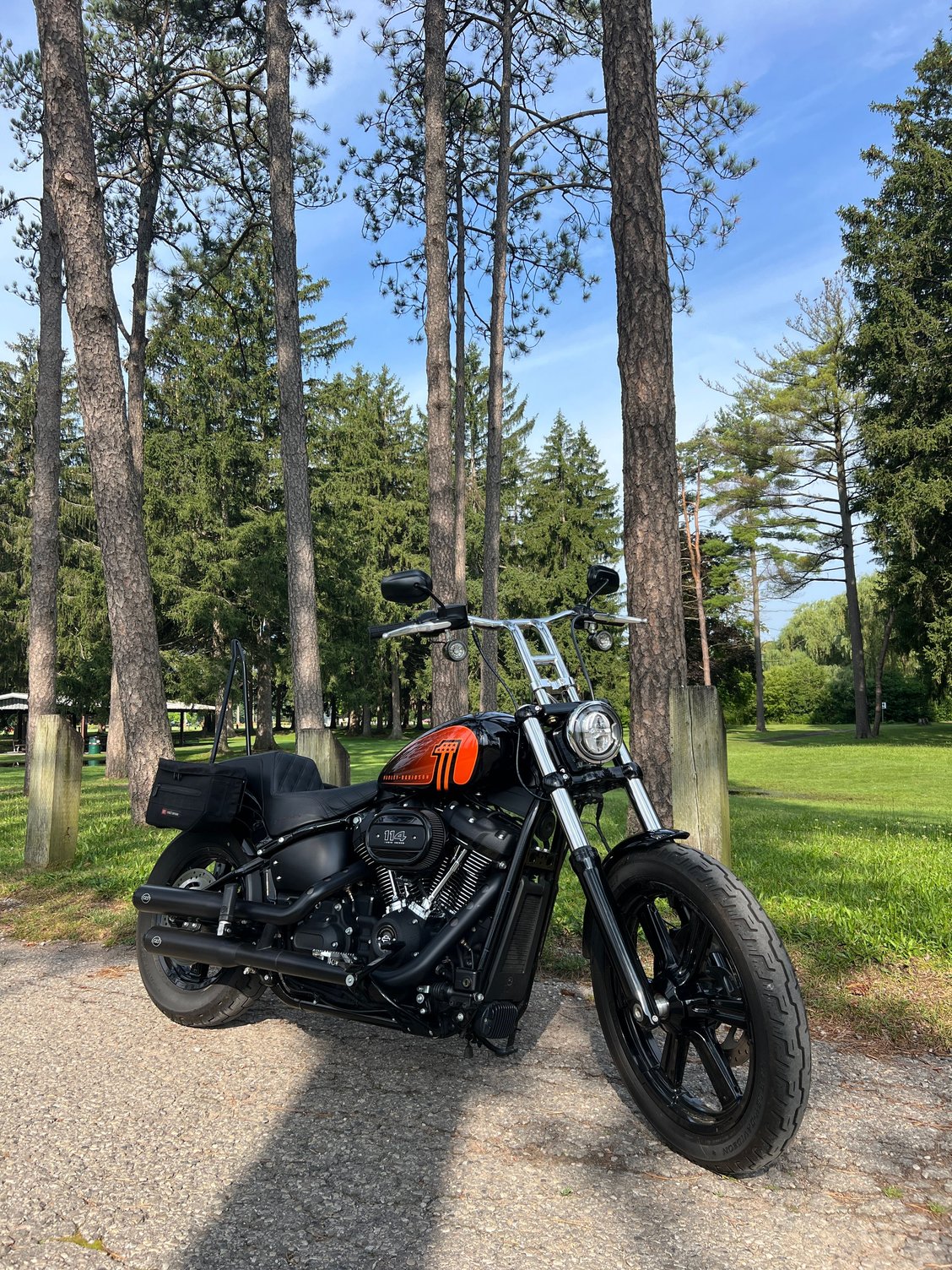

Went exploring the new neighborhood some more and stopped to take some pics at a park

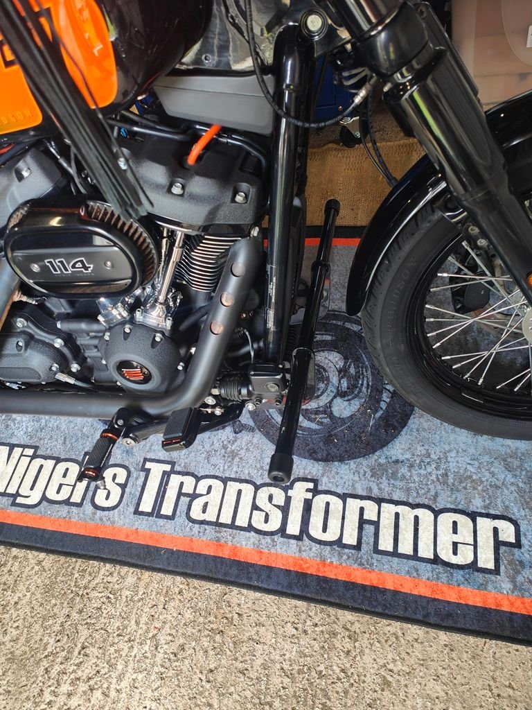

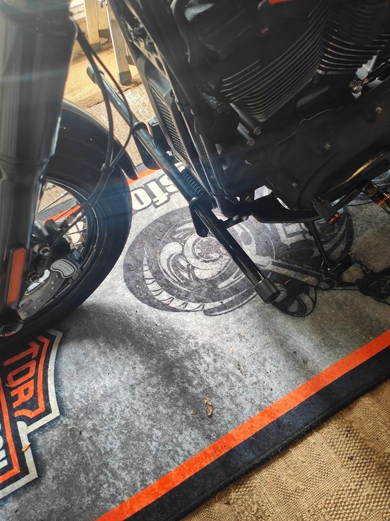

Fitted a Craftride front crash bar
