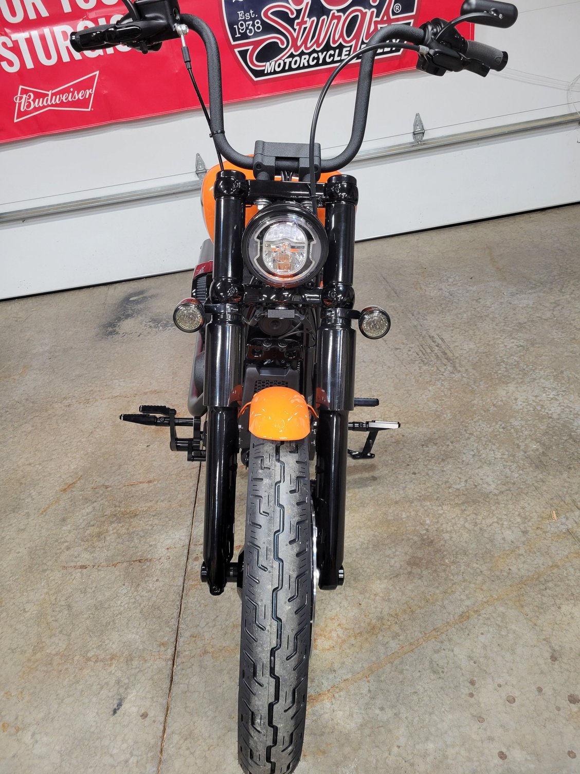

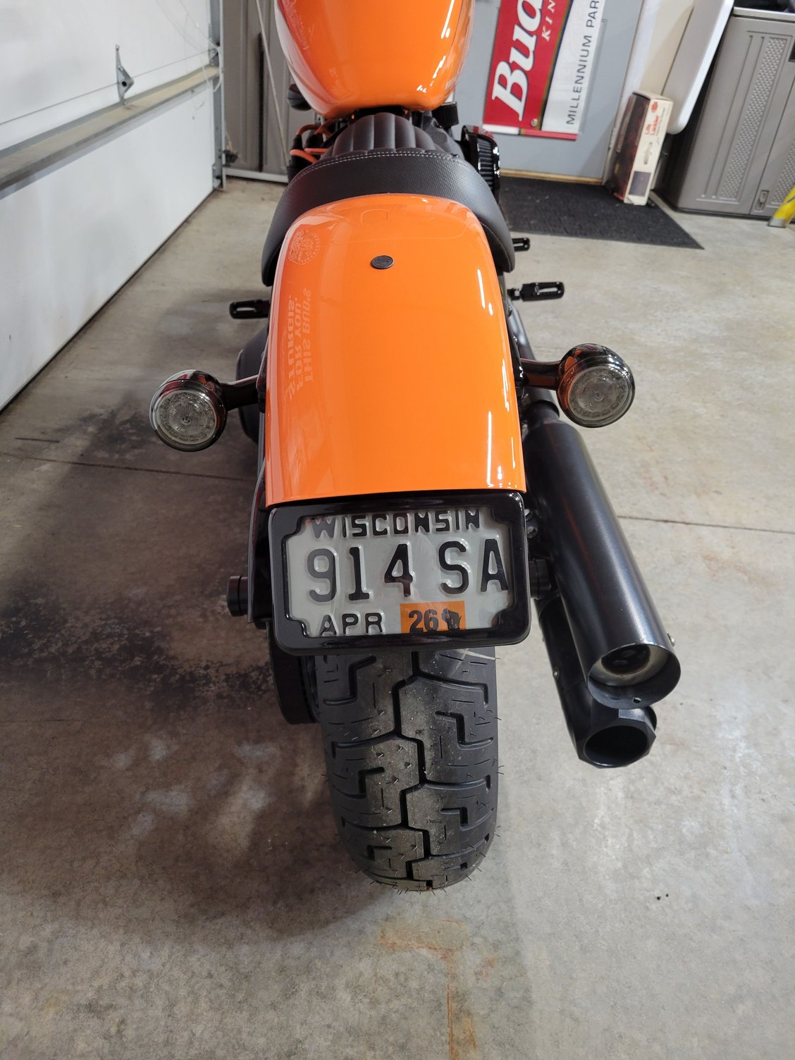

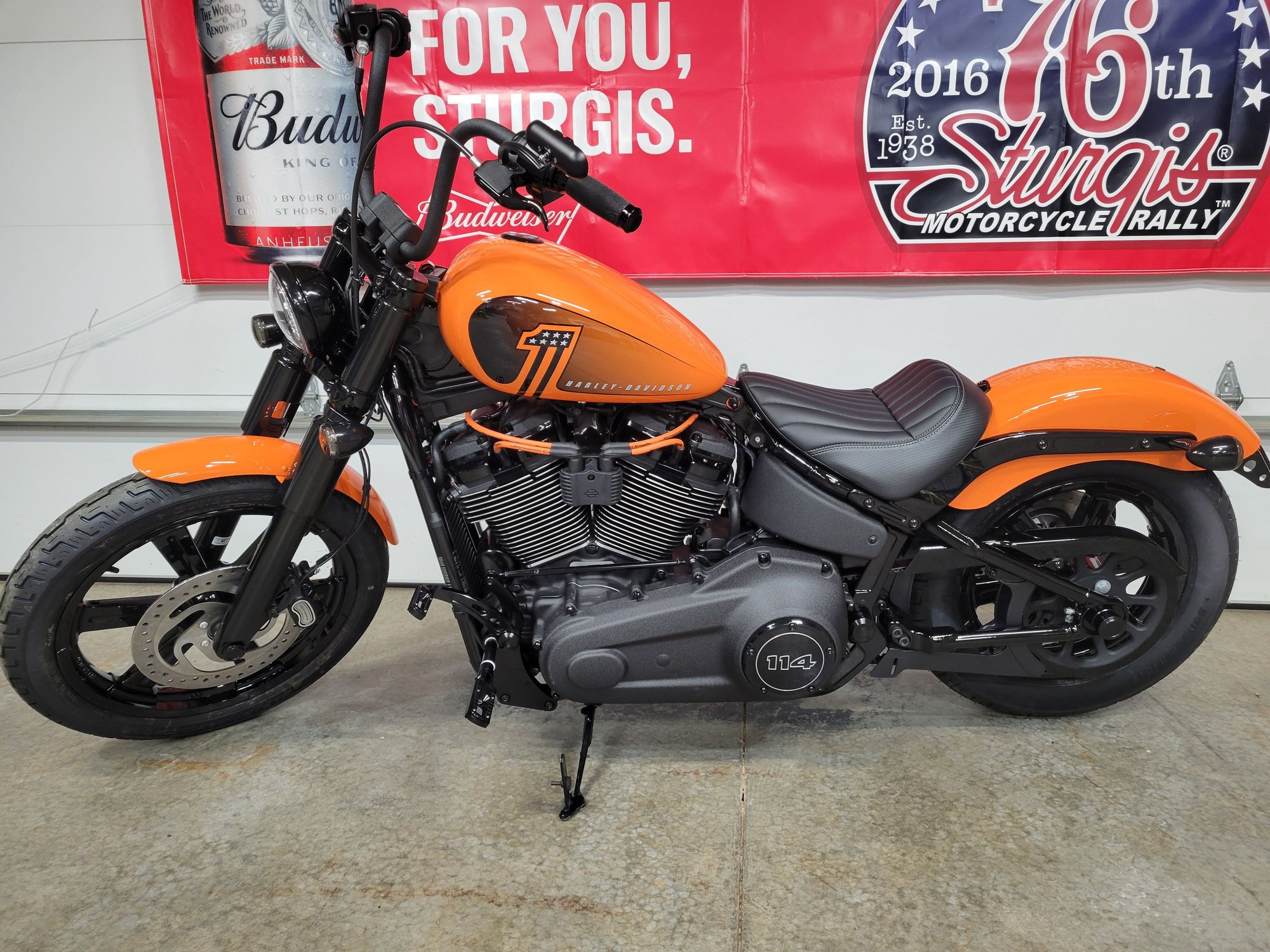

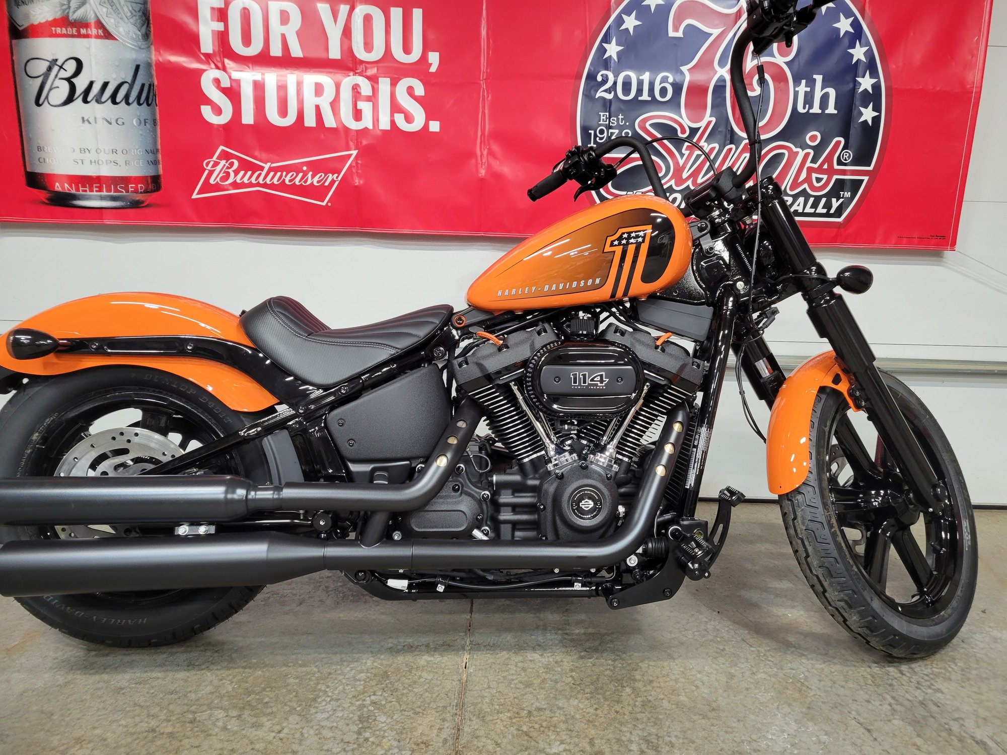

I added:
Front aand rear axle covers
Swingarm bolt cover
Fork covers
I cut down and powder coated the stock levers
Powdercoted the headlight trim ring
Powdercoated the side covers in wrinkle black
Tank lift
Added cruise control
Added forward controls
Security siren
Custom Dynamics LEDs front and rear
Smoked lenses
Custom Dynamics flasher
Cycle Visions license plate relocation kit
Tab mufflers with medium baffles
Blacked out hardware with Ciro bolt covers
Front turn signals relocated
Turn signal button extensions
Flush mount pop-up fuel cap
Spark plug covers
Removed the reflectors
Get-AGrip grips
Breather bypass
Oil cooler screen
Arlen Ness mini ovals mirrors
Kodlin 1.5" lowering kit
Orange SE plug wires
K&N filter
I'm still waiting for my upper exhaust tip to get back from the powdercoater. It got messed up the first time. I'm getting some thread and vinyl samples next week from Mustang for my Custom seat im having made. I'm going to put about 1k miles on it when the weather gets better before doing a cam and voiding the warranty. Then I can get the chrome off of the pushrod tubes and lifter blocks at the same time. I'm trying to find Baja Orange powder to do the lower rocker boxes then as well. I've been researching saddlebags or a swingarm bag or something to carry the essentials but not sure what I am going to do yet. This bike is brand new with 1 mile on the odometer. It was delivered on I think January 6th or 7th. I did all this work to it and as crazy as it seems, I have never even heard this bike run!
