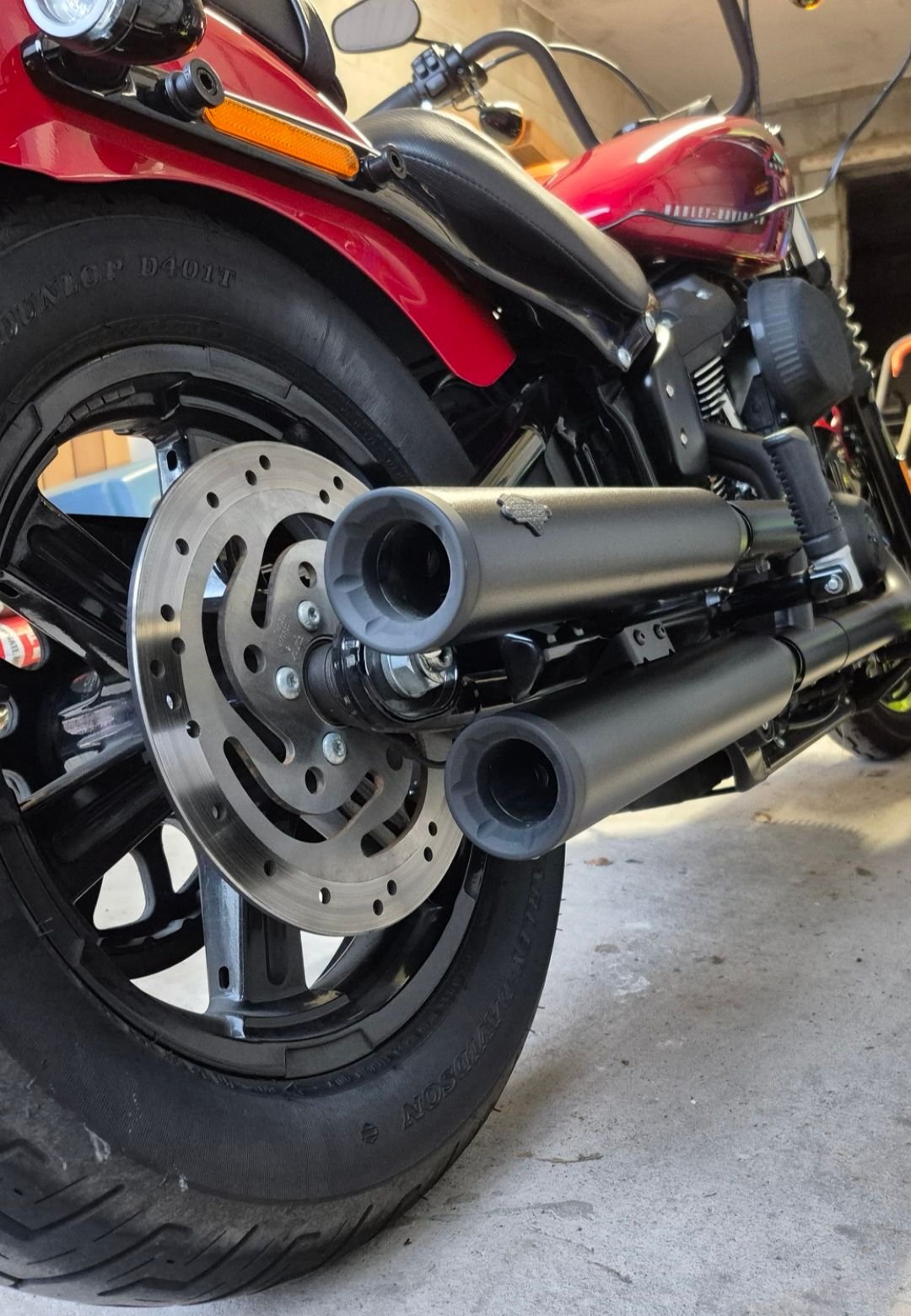

Biggest changes so far today with eliminator 300s fitted and a Dynojet tune.
Also a change to the other side with a genuine HD swingarm bag. As new condition off EBAY for less than Ł100

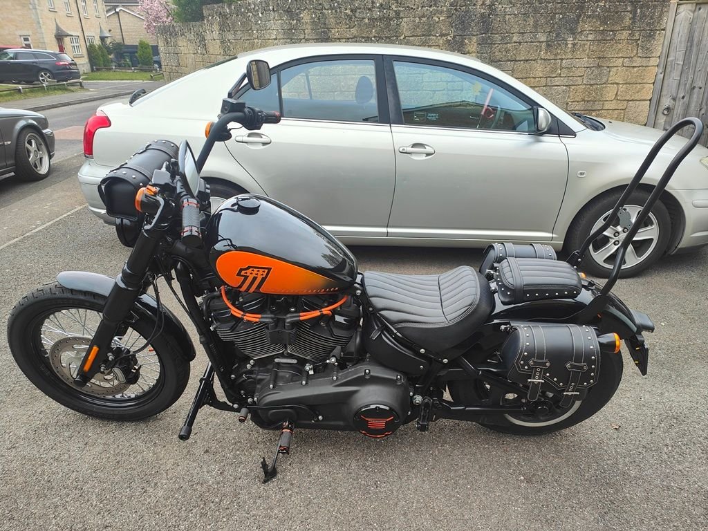

A very sad day....
despite all my efforts to get it setup for my OH, we're going to have to sell the Street Bob
We even went to an airfield to give her the best opportunity in a safe environment for a final test ride.
Unfortunately, she just can't get on with it - she's absolutely gutted!
So today was spent, checking it over, sorting things out, taking pictures and advertising it for sale.
