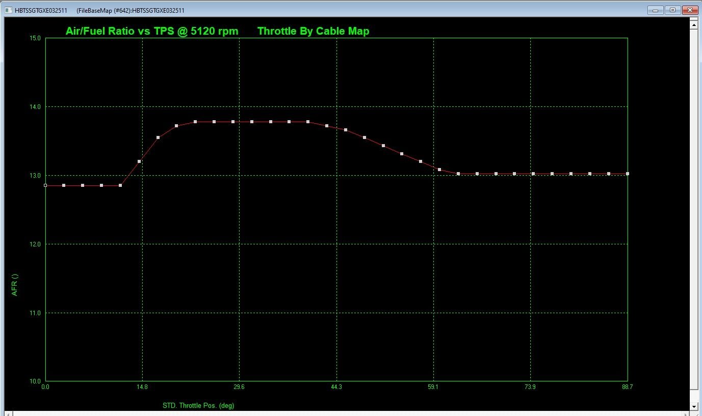

Lemme be the first. (Well, if I hadn't doled out the entire "War & Peace" response I'da been first!)
Can you run Tmax with a canned map? Answer:yes
Will it be optimized to your bike so you enjoy the most efficiency, performance, and fuel mileage? Answer: No. Not even close.
I put Tmax on two of my bikes and by adjusting the fuel and timing, I tailored the running of the TC88 engines to my liking. I would consistently get 40-43 mpg after tweaking the tuning (originally saw about 35-38 on a canned tune). The biggest issue I saw with a Tmax tune was having the engine running from 5,000 to 1,500 RPM on decel with a closed throttle and a 13-ish AFR!!!! Why? I leaned out the A/F in those areas instead of activating the fuel cut-off.
Closed throttle is shown in degrees, so it never goes to "0". If I recall, mine is just left of the 14.8 line, which puts the A/F ratio like 12.8:1. That's like WOT rich!!!
It has been my experience that you'll find better torque and throttle response by tweaking the timing and better fuel mileage by adjusting the A/F ratios. Although, timing can help mileage too, if you don't go crazy. I never really tuned for WOT performance, since I rarely/never went there, but adjusting the Tmax maps where I regularly rode made the whole ride much more enjoyable. Even sitting at red lights. YMMV.

Hey Cobra. Just curious, what gas mileage are you getting? Did you run any "Automap" sessions after you've put a few miles on your bikes? That does hone in the "tune" a little closer to the particular bike it's installed into. I never had any real complaints about how the bike ran, except for the fuel mileage. I'm a tinker-er, so I set out to get better gas mileage. The final result was about five miles to the gallon improvement and a big smile when I twisted the throttle.

FatBob,
I agree that picking the closest "tune" to your bike is going to be the best bet, but I'm wondering about the section I've colored red. This has been my experience, but I WELCOME any information to the contrary.
You stated that Tmax could give you 14.6 AFR when the cam needs 12.8.
12.8 AFR is for WOT, which is just about what Tmax has in every base tune for WOT that I've looked at from Tmax (it's 13:1). In fact, It's been my experience that Tmax's AF maps for twin-cams are all pretty much the same. I've noted some changes in the later, drive-by-wire maps, but the cable-throttle maps I've seen are all the same. Even when you go up to 10:1 compression and for the 120 CI engines. All using the same AFR.
Where I think a major change might be is the timing tables. Depending on the cam and compression, the timing could change drastically. Even changing the valve events will change compression, and therefore, timing.
Since Tmax is wide-band, it adjusts to what A/F your "tune" tells it to be at every operating parameter (just as you said). So there never should be 14-something when it's calling for 12.8 I'm trying to understand how the cam could change that. Please explain.
Just using it as an example of how grossly mismatched parts could create a significantly different need in real AFR vs the map's commanded AFR. Not intended to be actual numbers. Didn't mean to cause confusion; I tried to edit that paragraph but the time limit had already expired.
