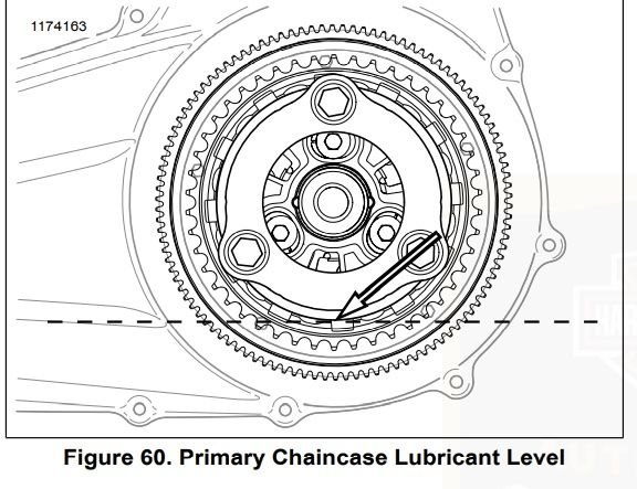

Way over filled primary. The oil level should just touch the clutch basket while vertical. If the bike is on the jiffy stand with the derby cover off, oil should not pour out, maybe just a dribble.

I mis-read that you filled on the side stand. So not way over filled, but probably still a little over filled. Get it vertical and use a flashlight to see the oil level at the bottom of the clutch basket. It should just touch.

That's not the right level or the right way, and is probably too much.
As mentioned, bike upright, just to the bottom of the clutch basket.

Primary Overfill. Also adjust your clutch to 1 full turn out.
You fill the primary while vertical to the bottom of the clutch plate discs.
