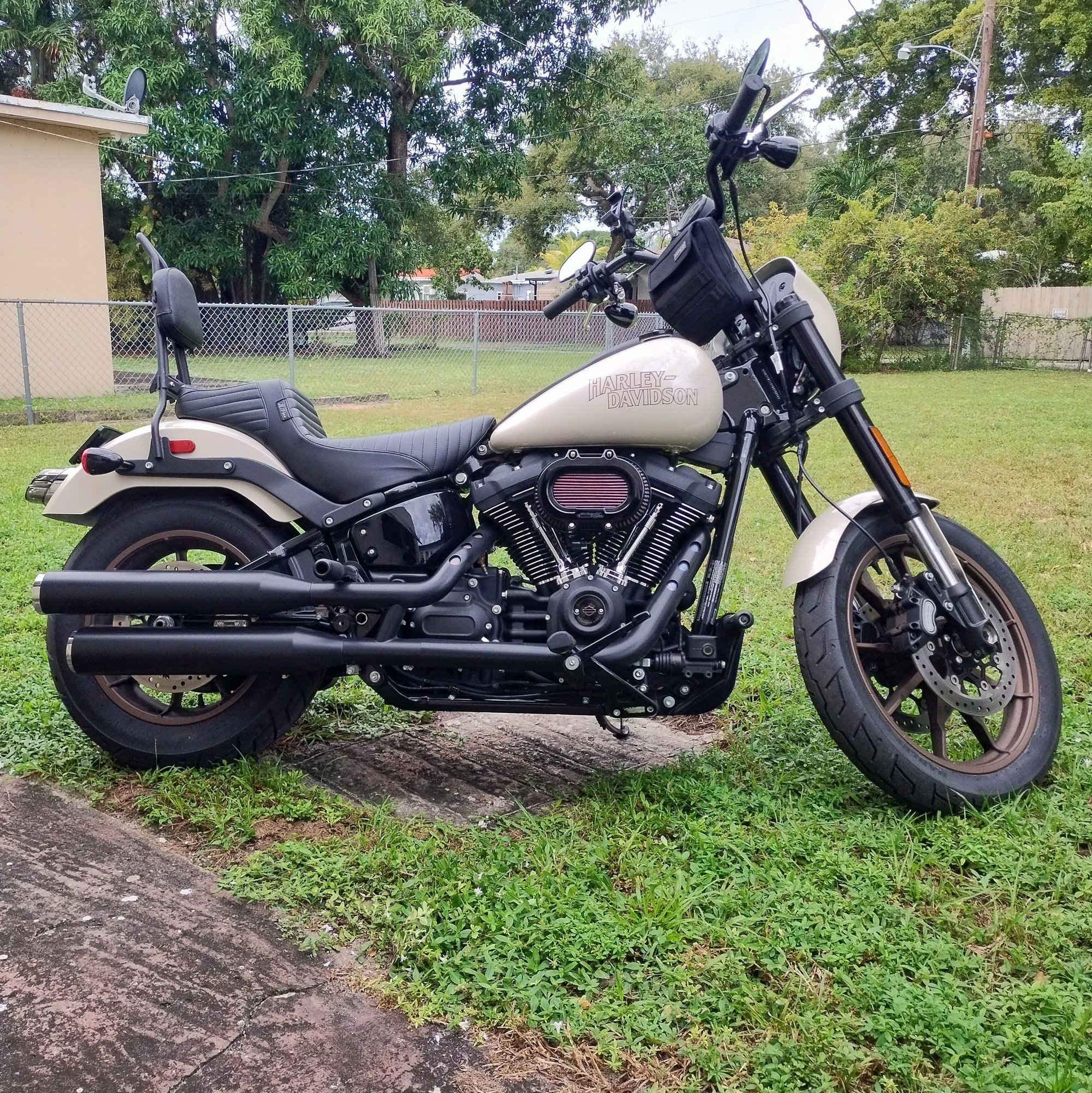

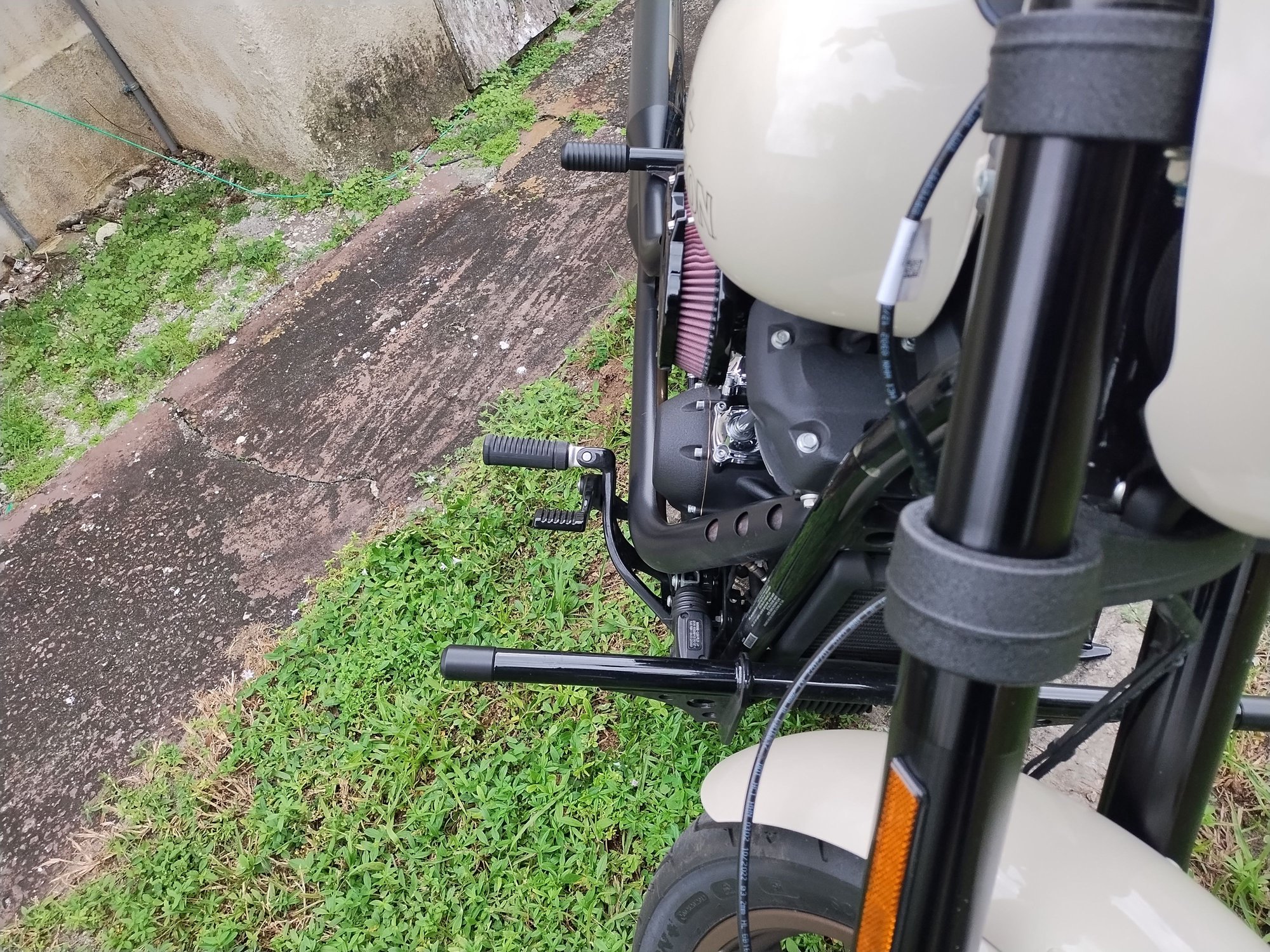

Necro thread bump. I settled on the Screamin' Eagle Ventilator Extreme Air Cleaner
I am really happy with it. Lots of leg room, and it works really well. At first, I wasn't sure I would like it, but I am really happy with the choice.
Thanks to all who replied.

250 dollars for the air cleaner, and another 200 dollars for the frame that holds it in place.
Performance wise, worth every penny. The computer is getting used to it. It's doing well for the otherwise stock 117, 50 state legal, and warranty intact.
