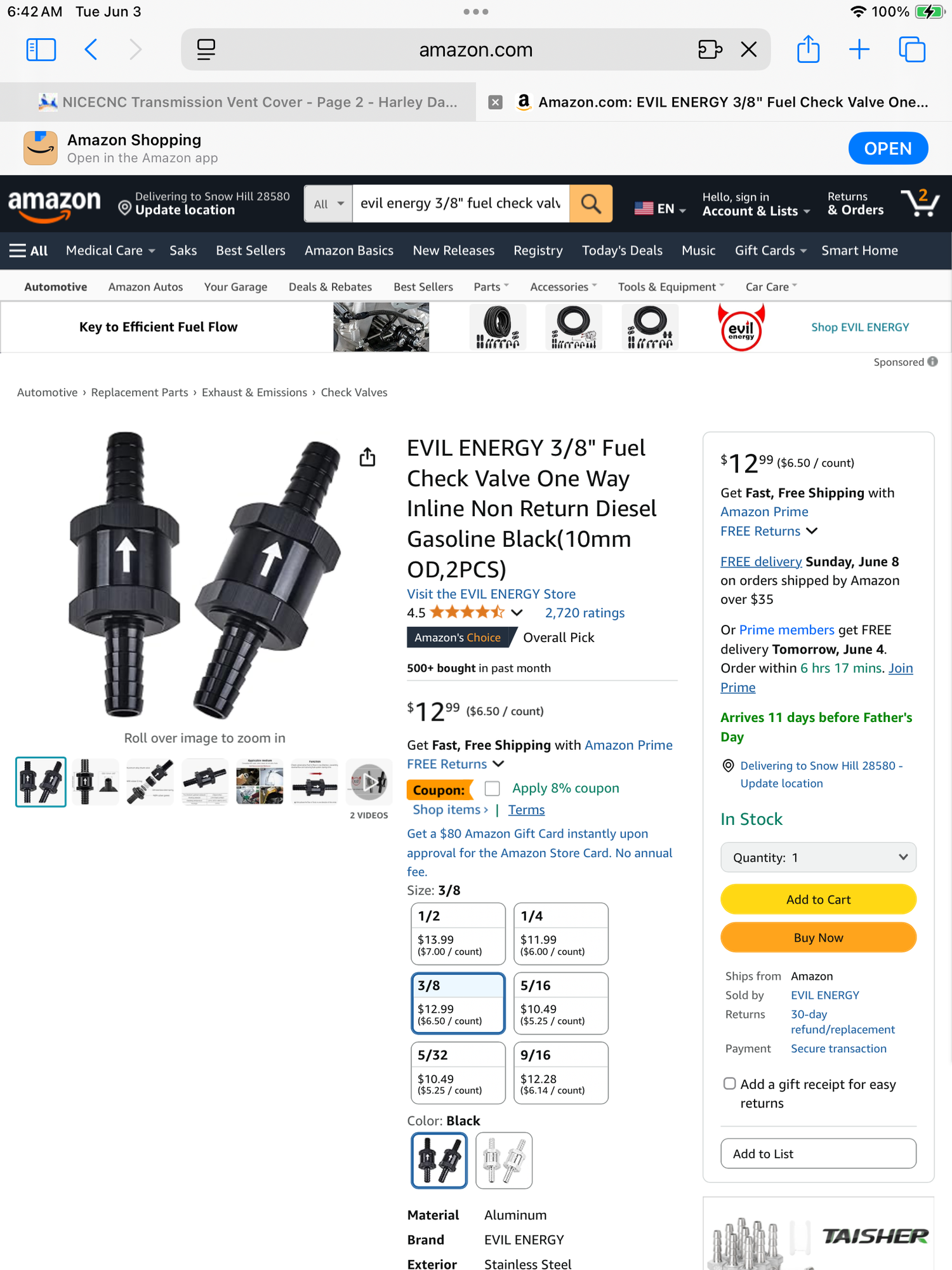

Originally Posted by Notgrownup
I don’t know if you absolutely need to keep vacuum. I did it on the advice of another member. I bought the valve on Amazon. I only rode with it 1 time so I’ve not seen any difference yet.
Been looking for a cool one way valve, thanks it on the way.
I was surprised at how nice it is for the price.
Funny they just came in less than two days and they were in the mail box, one blows pretty easy and the second takes a little more effort so I will use the easy one. Guess I have a job ahead of me next weekend off.
At the moment I have no check valve on my NiceCNC and it's working great . I also have the new Harley Cover it has no valve in it either .
