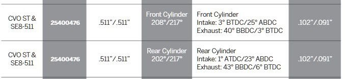

There are indeed a few cams for the Gen 2 engines. They already have 5.5 injectors and a 58 mm throttle body, so they do respond well to being pumped up. They also have a pretty aggressive cam from the factory, for a Harley anyway.
