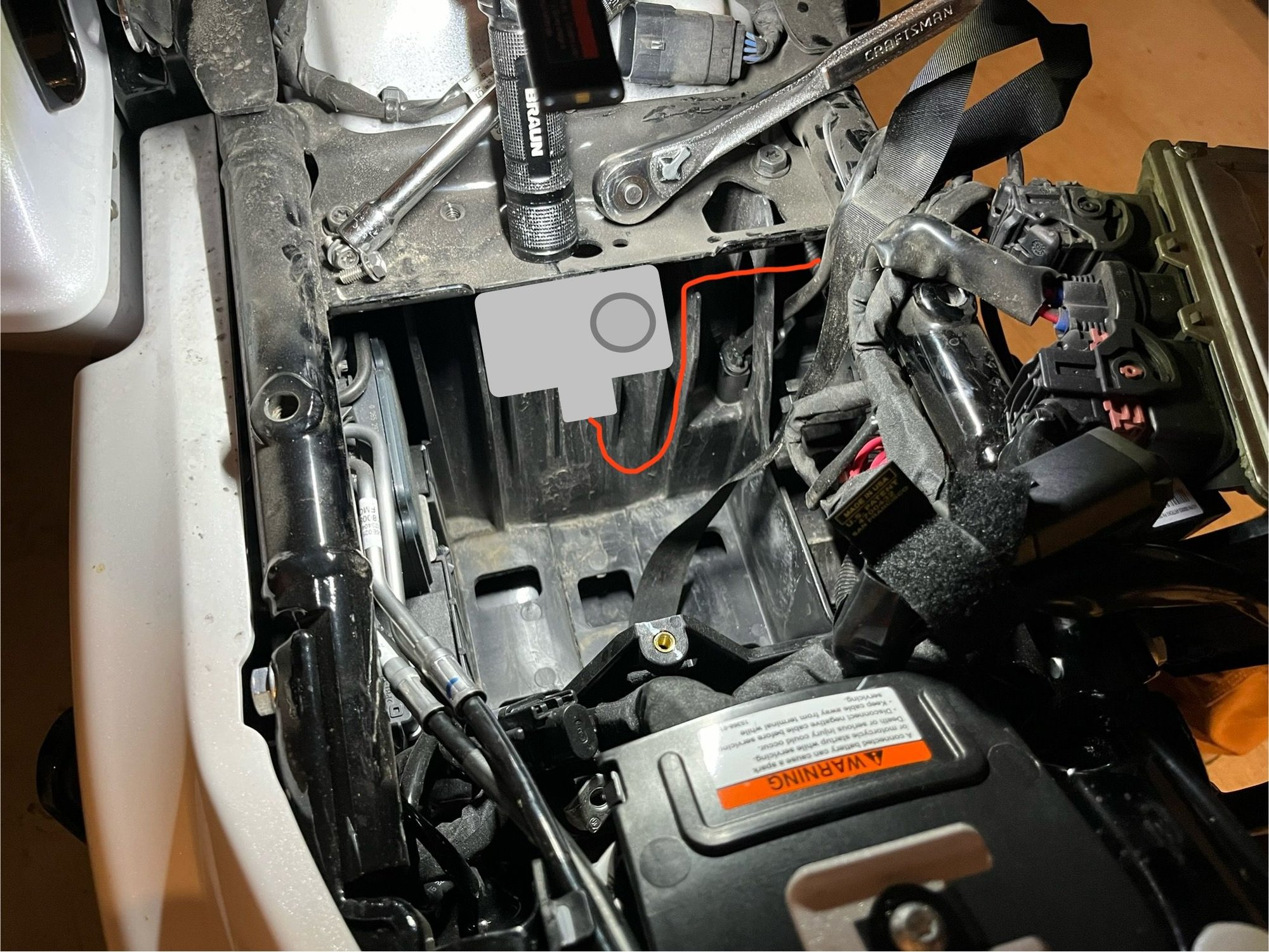

Installed the siren tonight. Turned the chirp off.
Pretty straightforward install. Take off seat, remove top caddy, remove BCM and it’s caddy, then pull battery. Set siren in its spot and plug it in.
Naturally I didn’t take a picture after the install but this is where it sits
And in order to get the cable out of its holder, you can just reach above the drive belt to unclip it.
