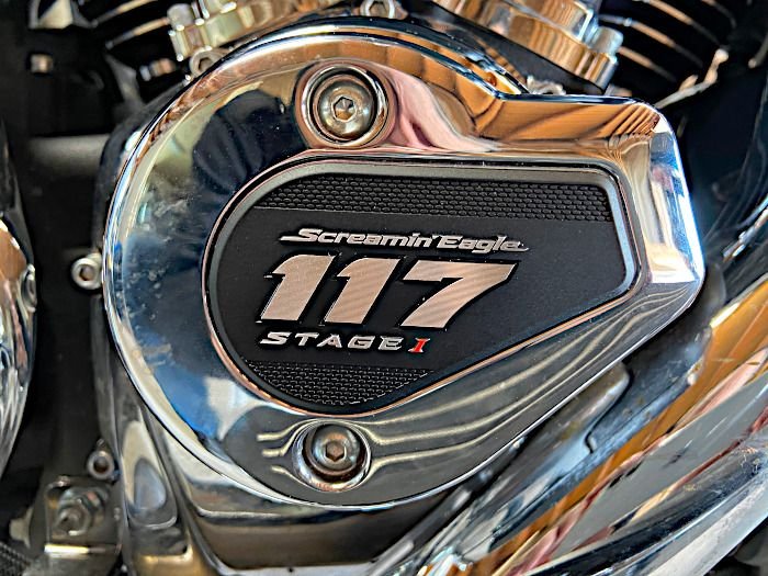

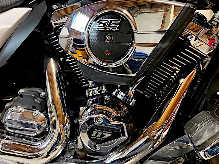

So I tied the ribbon on the tune..
I had to order the 117 Stage 1 timer medallion and it came in yesterday. I installed it along with the air intake trim that was included with the SE air filter. So now I'm officially Stage I
