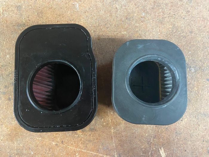

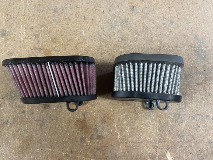

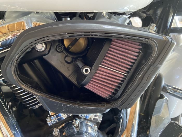

I installed this Screamin' Eagle High Flow filter last Saturday https://www.harley-davidson.com/us/e...rim/p/29400494
I took some pictures to compare the SE filter vs the stock.. (Just found them on my phone today and figured I'd post them so anyone considering the filter could see the difference). The SE filter is noticeably larger, so it must flow more air. Hopefully it's the 36% more that they claim. Here are some shots from the same side angle and some from the intake end and one of the filter in place.

[QUOTE=jwt873;21706753]I The SE filter is noticeably larger, so it must flow more air. Hopefully it's the 36% more that they claim.[QUOTE]
the increased filter area AND the filter media being more porous than the OEM paper is the reason .. I have never been a K&N oiled cotton filter fan because along with more air passing through, there's more airborne contaminants being ingested ... but unlike the ones flow directly into the throttle body with velocity, this design with the backing stops that from happening so dirt is less intrusive, in theory anyway ..or so it would seem ... either way my airbox has been surprisingly clean and much better than previous ones so I'm calling it a win using the K&N for my application
